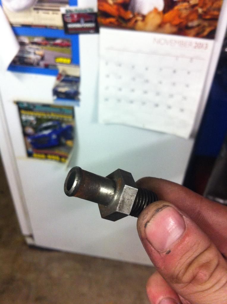

    So my engine guy gave me this bolt and said I was gonna need it. soooo yeah here it is and what is it?

    It looks like it is the fitting for the throttle body coolant return line that threads into the block, at the #6 cylinder, under the intake manifold.
    Number 28 in the diagram.

      Bam, thanks buddy. I've been staring at this for awhile surprised I didnt see it.

        that screws into the block near cyl 6 on the cold side of the engine
        number 28
        http://www.realoem.com/bmw/showparts...17&hg=11&fg=10
