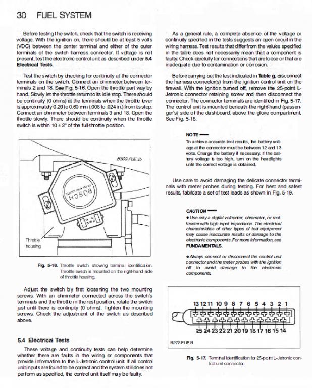

        WOT switch is a possibility. If the switch doesn't close, you are running with the higher advance numbers of the part throttle map. You might blast through that area fast enough in the lower gears to not really notice it.

          So sure enough I am getting detonation in other gears. It looks like it is load related. Since I heard nothing in 1st or 2nd gear I tried it going uphill, then I heard a little detonation. 3rd & 4th gear still much more pronounced and while going uphill it starts sooner, like 4500 rpm with an AFR of 13.5
          I will check Bentley for the WOT switch and see if I can test resistance or something.

            You can test the TPS yeah, and I have a new one from the dealership if yours ends up being a dud if interested.

                    Nothing new, I have been chasing this gremlin since I bought the car in Oct 2013. I have tried a bunch of different gas stations Shell, Chevron, Texaco, all 91 octane all result in same issue. I have tried 3 different chips, tuned by 2 different people same results. At one point I thought it was the M30 AFM I had, that's when I put the AFR gauge in, saw how lean I was. Put a stock AFM in and now my AFRs are good but still have pinging.
                    I will check the TPS/WOT when I get back on Sunday. Thanks guys!

                        Ok I took off my TB and checked the resistance per the Bentley manual. All looked ok, adjusted the TPS a tiny bit. Still have the problem. At this point I'm thinking of going straight stock, that is...put in stock injectors and ECU and see what happens. Unless you guys have other ideas.
