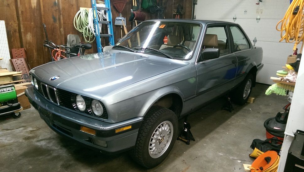

    Heres a picture of the car... I cant wait to drive this thing!! I just want to get this started and drive it for at least a few weeks before winter hits..
