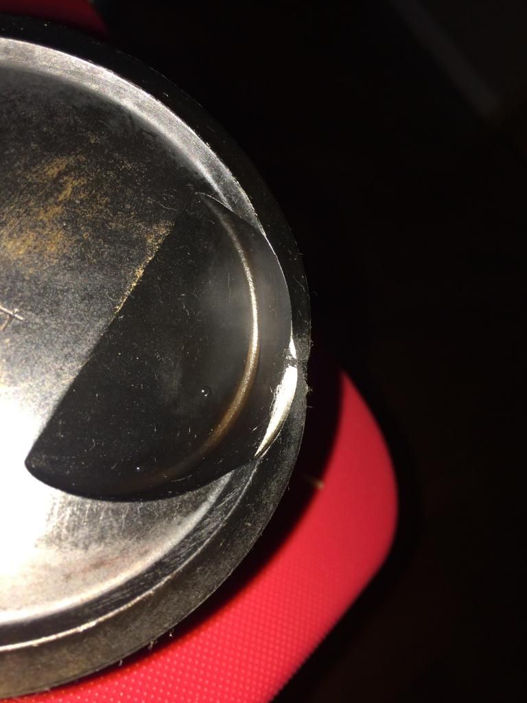

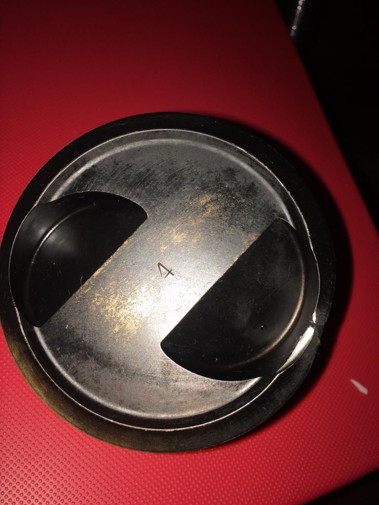

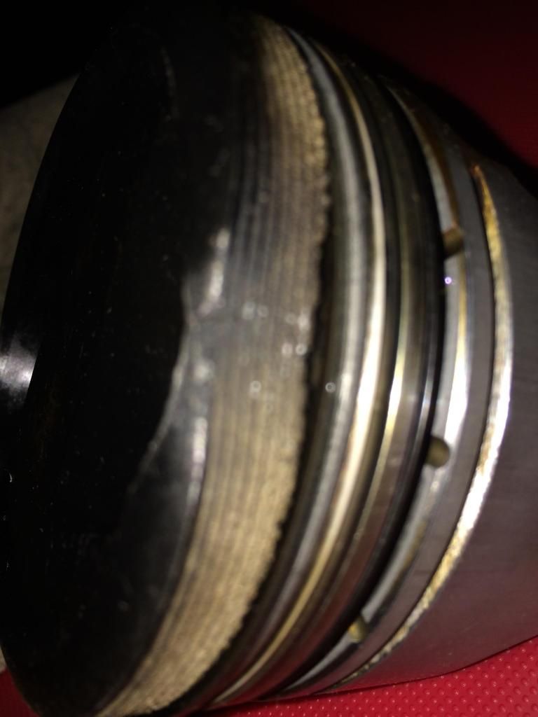

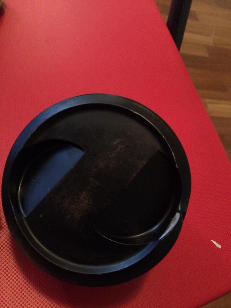

    anyone know the cause of this? , also thinking that the ARP headstuds weren't tight enough and caused the cylinder head to lift up a bit but this looks bad , engine was still running strong but burning oil so I tore it apart and just swapped in a stock I m20b25 for now

      That would be my guess. Just on the one piston?

        nope on all 6 , and the sides are just as burnt

          What was your valve to piston clearance when you assembled the engine?

            Also, post a better picture of the side/corner of the piston where it is damaged. It looks like some detonation damage right at the thinnest part.

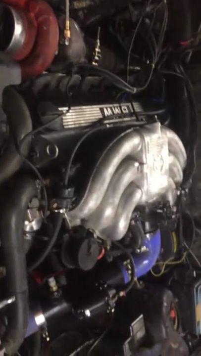

                            here is the healthy new motor running just stock m20b25 ARP headstuds stage 3 spec clutch

                              Hard to tell by the first pic but to me it looks like it got hot and deformed and the edge of the piston top pushed up and in because of being so thin there from the valve pocket and deformed far enough in the valve hit.
                              On the last pic if you follow the valve pocket it looks out of round where the burn part is, probably not much metal between the bottom of the valve pocket to the ring groove.
                              More/clearer pics are needed 8^)
