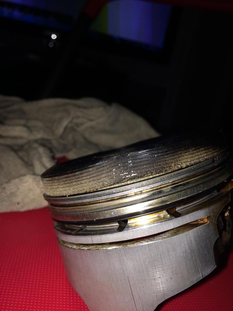

    You should have posted this photo, it's by far the most telling... Obviously what happened is that the thinnest part of the piston gave way under heat and pressure.
    My guess is bad tuning... And why a 272 cam? Do you have a pressure differential in-favor of the intake side? Meth makes me think high boost and as stated before...

      that's my bad on not posting that pic didn't really pay attention , the motor had the 272 when I got it so I kept it in there .its fine either way I had back up motors just in case something like this would happen I just wanted to see what everyone thought

          based on that pic i get
          thin valve relief to piston ring metal -> gigaboostu pushes piston skirt out -> piston drags up on wall, deforms valve relief -> clearance to valve decreases below 0 -> contact
            Take a look at the surface roughness on the side of the piston at the upper ring land. See that textured, sandblasted look? That is aluminum being eaten away by detonation which caused massive heat and pressure and pushed the softened piston upwards til valve contact. I bet if you measured the piston it would also have a flat spot there from being pushing in as well as up by the forces.

              to me it looks like it got hot and deformed

                            That is result of pre-ignition or detonation. Result of poor combustion chamber characteristics, you can't just slap some pistons and expect it to be all OK. You got to have correct quench areas for the flame front to start ignition always at the center. As I see there the compression ring got hot so much that it acted as a spark plug.

                                By looking at the pics .... You have detonation at full boost and It was starving for fuel big time. What injectors were you running ? Definetly the tune also needs to be looked at.
