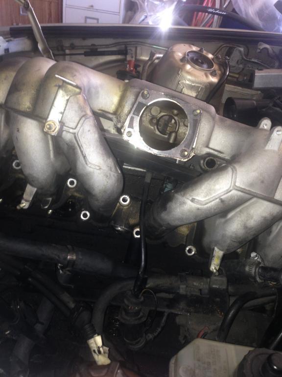

    Small update pt 2 - Did some little work today and I finally got the intake manifold out! :D Damn, I swear I lost like 5 pounds in sweat just wrestling with it lol Ether-D wasn't lying about the "bitch tube"

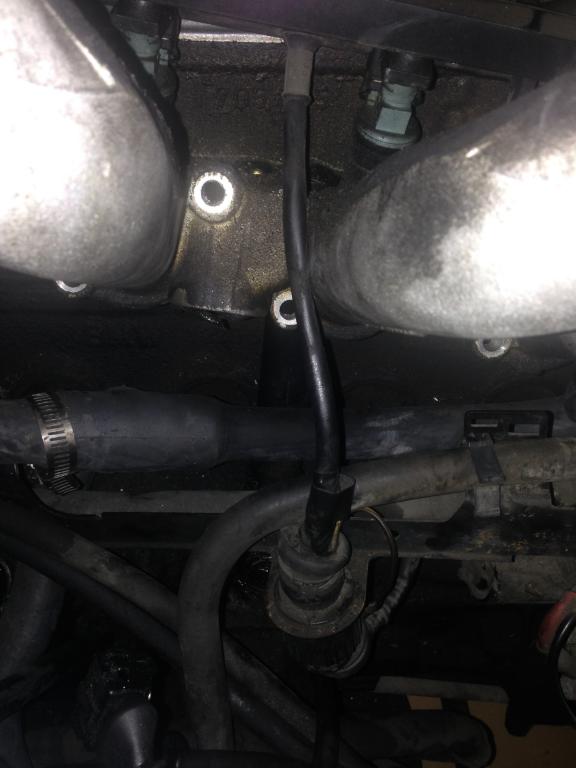

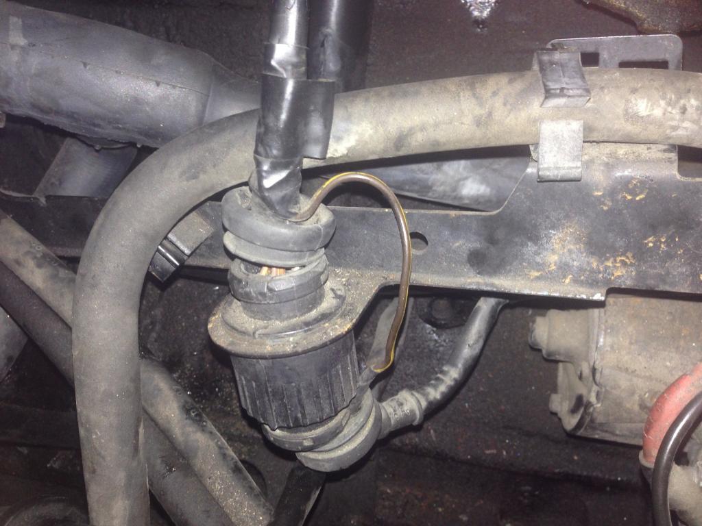

    But now i'm stuck again.. There is a wire from the fuel injector rail stuck to this bottom end and i'm unsure how to remove it anyone know ?

    and here's the bottom end of it
    (plus that wire sticking out; is that normal?)

      That bottom plastic part with the lines around it is a connector. Turn it and it will come apart.
        Does it just slide off after I turn it counter clockwise ? I've been messing with it and it just turns a little amount, not even half way.

          It may only turn a quarter turn or so. That wire has be been rigged in there for something. Maybe one of the connections fried or something. Just cut it then splice it back later.

            As it turns, it will pull the plug apart.
              Turn it like you would the O2 sensor (to the left) plug and hold both (top and bottom) ends. Then start pulling. The connectors inside are old and corroded, thats why it doesn't want to let up. Don't forget to spray some MAF sensor cleaner or any other contact cleaner to clean them up a bit. Also, there is a thingy right under the harness that holds "top" connector and the harness in place. Screw that off too.
              Mine doesn't have any external wires, and judging by the electric tape on the top connector it looks like a bypass (imo the connectors are toast, or at least one). Replace.

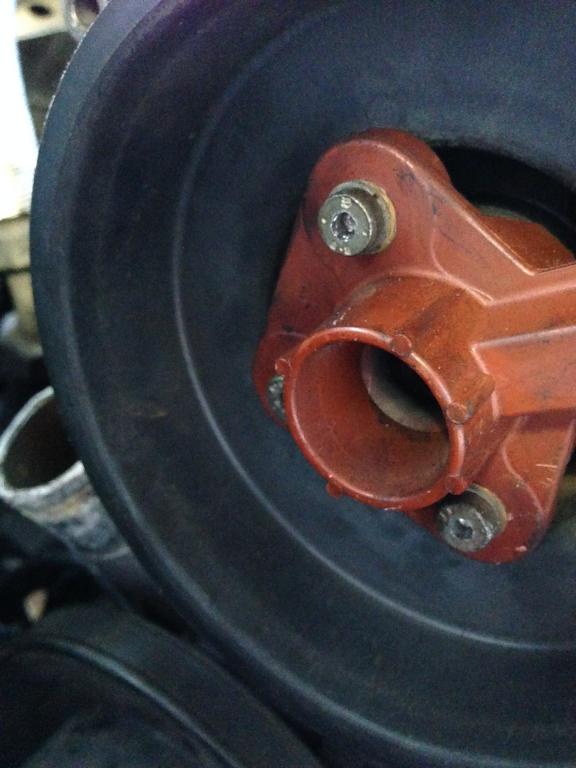

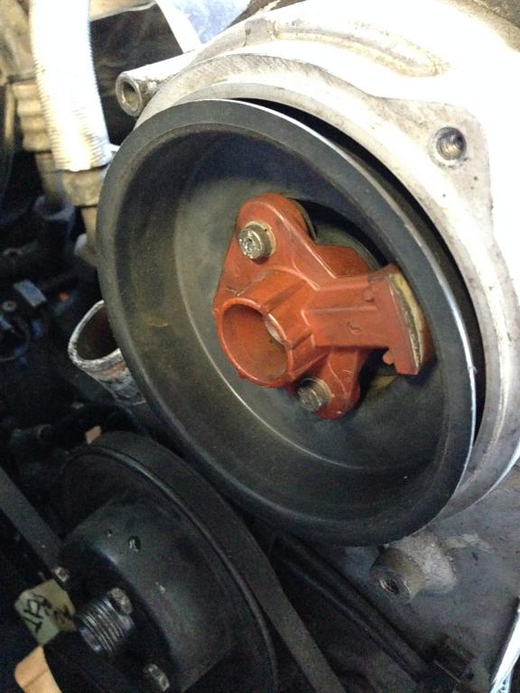

                But as always theres small problems that you'll come across like my most recent is that I can't take off the redish rotor that is in front of the timing belt cover since the 3 screws are stripped :(

                Now I gotta figure out how to get these out.. (btw anyone know the part number for these ??)

                  Not sure what the best way to remove the stripped bolts is - I've read that a Dremel works, but evaluate the sense of that approach for yourself. Vice grips maybe?
                  As for bolt part numbers, a new rotor will come with new bolts (I'm 99% sure you can't buy just the bolts...unless your local nut/bolt shop has a really comprehensive selection of stock), so...you have to buy a new rotor...or, find a used one - they are removable.
                  Also, stripped bolts aside, looking at the state of your rotor in that top picture, it's looks like it's about due for replacement.
                  Rotor part number: 12111715906
                  Cost is approx $30.

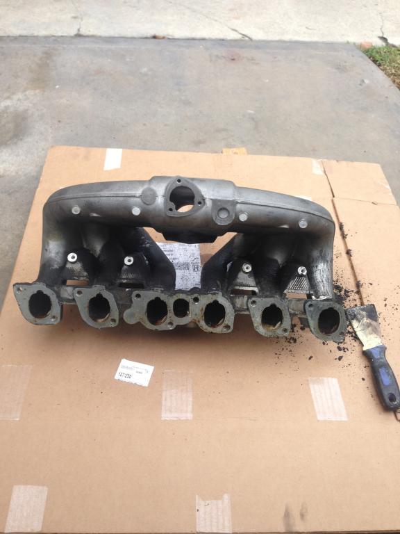

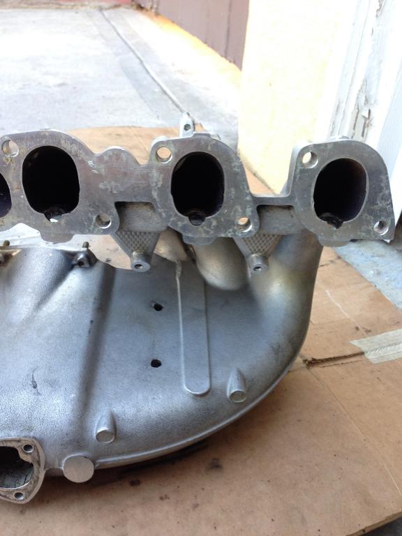

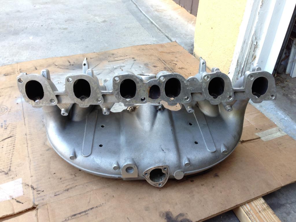

                    Also some before and after pics of the intake manifold
                    Using some carb cleaner

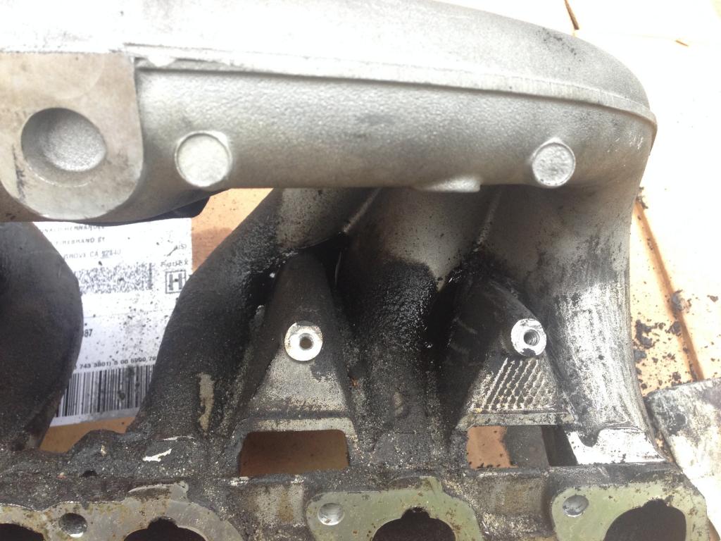

                    still gotta clean up the heads where the gaskets go with a blade

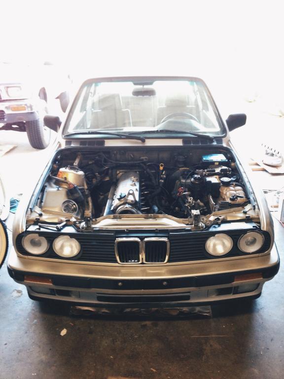

                    Andddddddd here's how he sits so far....

                            Use a dremel on the screws to create a flathead notch.

                              No no no. I used a pair of vicegrips and it worked great for the stripped bolts on the rotor.
                                Yooooo E30NJ when u making a new video man ? :D haha
                                And I feel like this would work. Are they the same lefty loosey type of screw or are they clockwise ?
