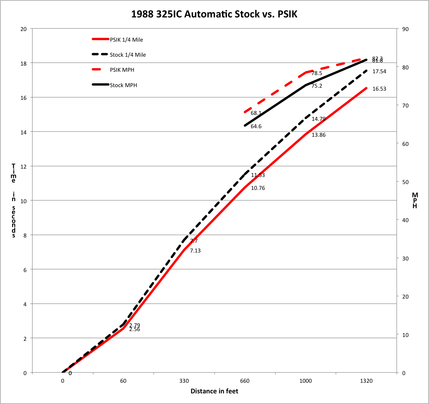

                    Originally posted by digger
                    the lack of independent data doesnt help the PSIK which i do think is good value for someone who wants a little more fasts, a mostly plug and play solution and has no grand plans for the m20 making alot of hp.
                    The "independent data" card is getting old. There are plenty of shops, race cars and people who have provided data and highly, highly recommend the PSIK over the last few years. We aren't new to the game and our reputation is pretty strong.
                    Just a month ago or so a customer shot me some 1/4 mile data from his AUTO 325i VERT which picked up over 1 full second and a 4 MPH when compared to the same car without the PSIK.
                    https://www.millerperformancecars.co...IK%20times.png
