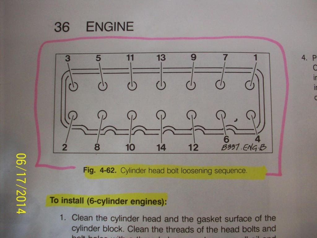

                      When you removed the head, did you follow this sequence of loosening the head-bolts? See pic from Bentley.
                      Some "relaxing" may occur during the removal - but if done properly - there should be no warping. Even if there is - a good headgasket should seal with some warping..

                        Wow, thanks for all the information guys! To be clear, yes I followed the torque specs from my bentley manual. I'm very familiar with torquing do to the nature of my job, so I'm absolutely sure its torqued correctly. Perhaps its not a warped head after all. If I have time today I will recheck everything whodwho suggested and see if it will attempt to start. After that I will do another compression test wet and a leakdown and report back with my findings. An employee at the shop was helping with the compression test, perhaps it was not done properly. Hoping for better numbers this time! Thanks again everyone.
