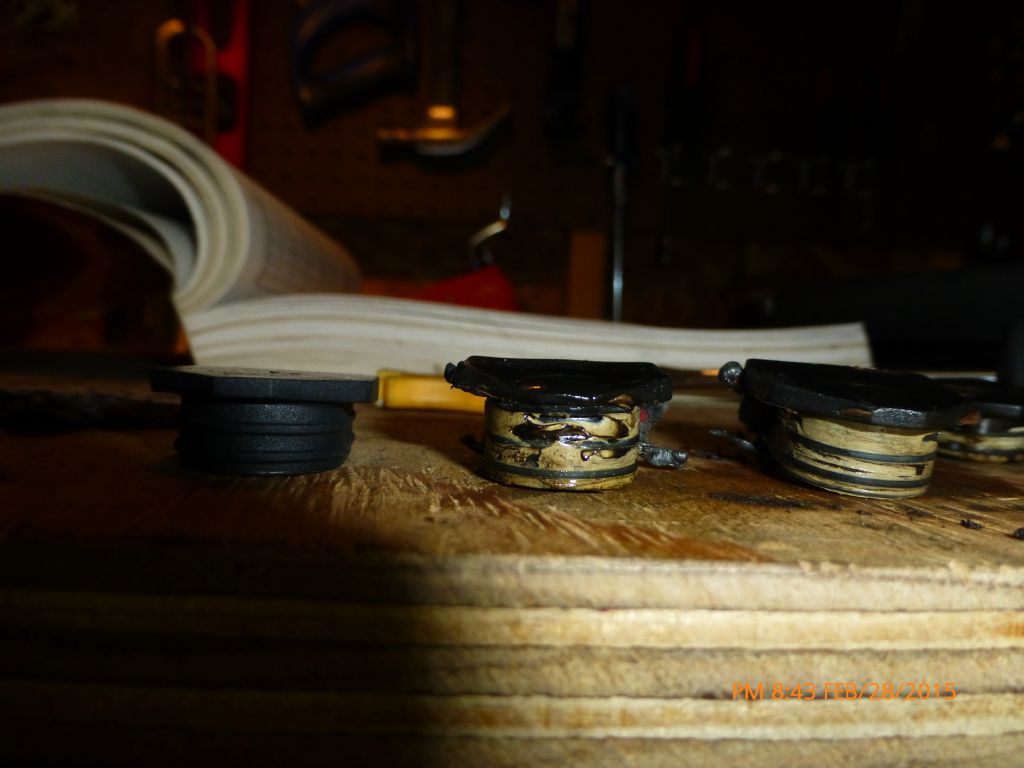

                      Yep, I got it degreased (the front at least), now I'm waiting for my parts to come. Gonna do the valve cover gasket itself, the 4 rocker shaft rubber plugs, and the camshaft seal + o-ring. I'm also gonna do the oil pan gasket and that will include changing the oil filter too.
                      Not in 'mayo mode', so yeah I'm not gonna do the HG now.
                      Thanks for the info!!! Saved me time + $! (and possibly other issues)

                        Source of the leak: rocker shaft plugs
