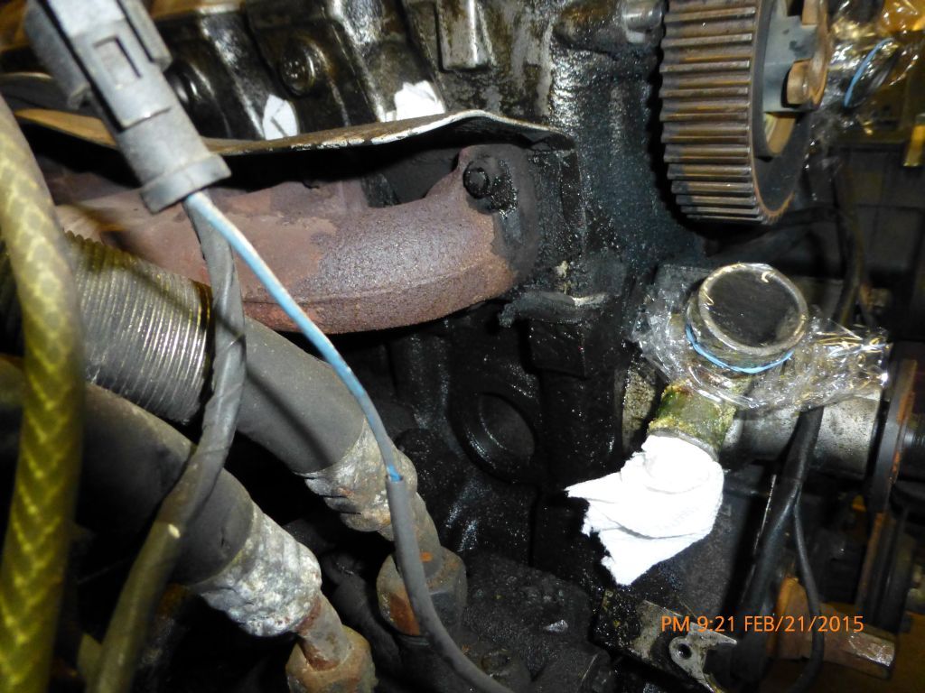

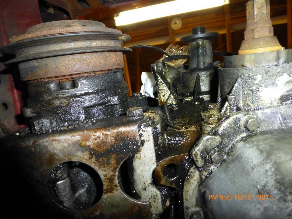

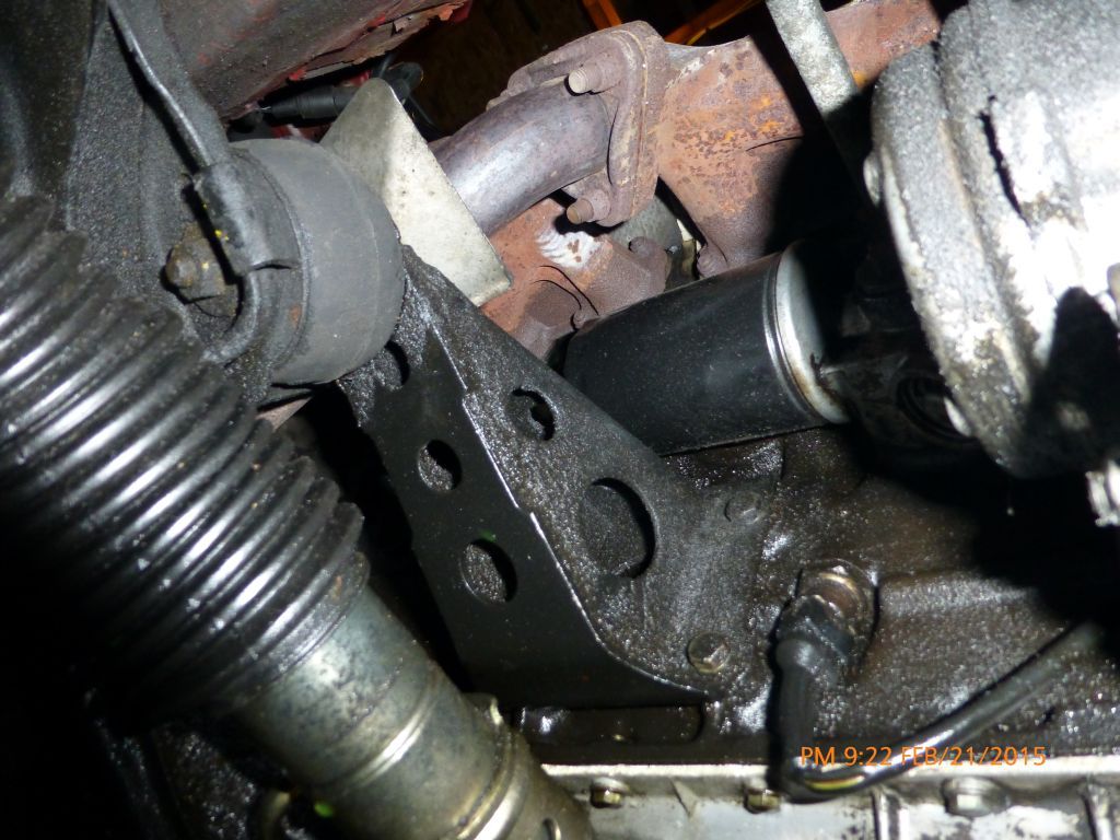

    My ignition refresh job turned into a timing belt job which now I'm considering turning into a head gasket job. I have the timing belt off so I already disassembled the stuff at the front of the engine. I knew that I had an oil leak (drips even when the car hasn't been run for weeks), but I figured it was probably my oil pan gasket and camshaft seal (I'm gonna change both of those). No mayonnaise that I can see. Now that I have better access, I'm pretty sure it's a leaky HG (pictures attached, although some of that stuff is coolant from when it splashed around when I was draining it). Last time the HG was done was in 1993 @ 55k miles. The car has ~240k miles on it now. Oh yeah and I did the valve cover gasket about 3 months ago (but stupidly didn't know to do the rocker shaft plugs).
    So should I do the HG now (I haven't done a compression test or leak down test) or put everything back together, drive around a bit, do a compression test then consider doing the HG? My goal with this car is to turn it into my DD by summer.

    I would clean all that mess off and see where the leak is actually coming from. It looks like rocker shaft plugs or the cam seal, not the HG, but impossible to know for sure with that much goo everywhere.
      Or you may have multi leaks but the start point for that leak looks to to too high to be from the head gasket

            But before you degrease it. An oil leak that's bad enough to drip will leave a "clean" spot where it's washed the dirt away. Look for that kind of thing and look for the highest point on the motor that you see leakage since leaks travel down (thank you gravity).

              Yeah maybe I was a bit trigger-happy with the HG. I'll hold off on it. I decreased it today (was a race against time before temps drops below freezing for the rest of the week). After I took the camshaft sprocket it looks like the plugs were leaking pretty bad, gonna change them. Also the steady daily dripping can't be the HG since the car wasn't run, so it must be the oil pan gasket, right?

                  Hard to tell, but looks like the leaks are above the oil pan, which to me means the valve cover gasket, the 4 x rubber plugs, etc....definitely need to degrease everything and then you should be able to see the leaks....could also be from the oil filter

                    Definitely check that cam seal. My block looked like that before replacing it and cleaning everything up. My head leaks some oil still, no oil/coolant mix yet but from what I read it's typical for the head to leak a little.

                      Yep, I got it degreased (the front at least), now I'm waiting for my parts to come. Gonna do the valve cover gasket itself, the 4 rocker shaft rubber plugs, and the camshaft seal + o-ring. I'm also gonna do the oil pan gasket and that will include changing the oil filter too.
                      Not in 'mayo mode', so yeah I'm not gonna do the HG now.
                      Thanks for the info!!! Saved me time + $! (and possibly other issues)
                        Source of the leak: rocker shaft plugs
