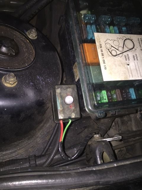

      Found this attached to the fuse box, thought it was a kill switch or something at first. Under the cap are two fuses that are intact with a green and red wire coming out of it. Have no idea what this is for. I checked the voltage on both sides of each fuse in the run position and all were good/battery voltage.

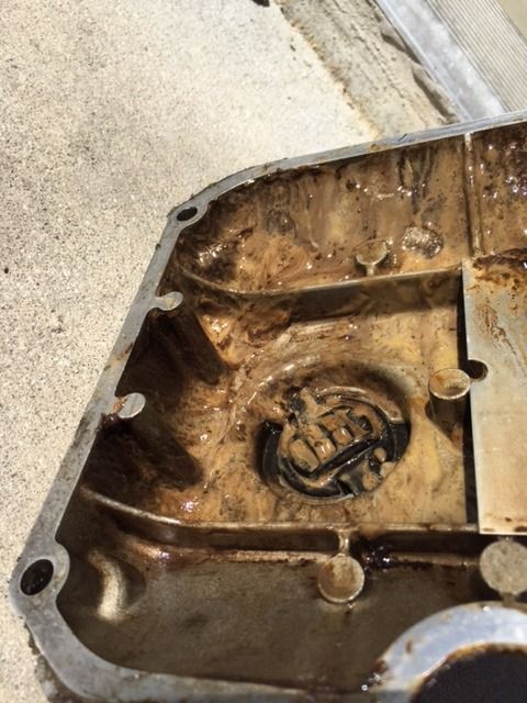

        Also, this is the under side of the valve cover, which could indicate a blown head gasket but it's not really the yellowish color it usually is when a head gasket is blown. I would assume a blown head gasket would only cause a no start no run condition if it was bad enough to not hold compression.
          do a quick compression test. if you have no compression in more than 2 cylinders it wont really start.

                  Found the problem today, head gasket. From 1 to 6 I have compression of 120, 0, 0, 40, 50, 120. Checked it twice, couldn't believe that it would be totally at zero on two of them. Thanks for the help.
                    0 does sound off. but if the gasket is bad enough it will be 0.
