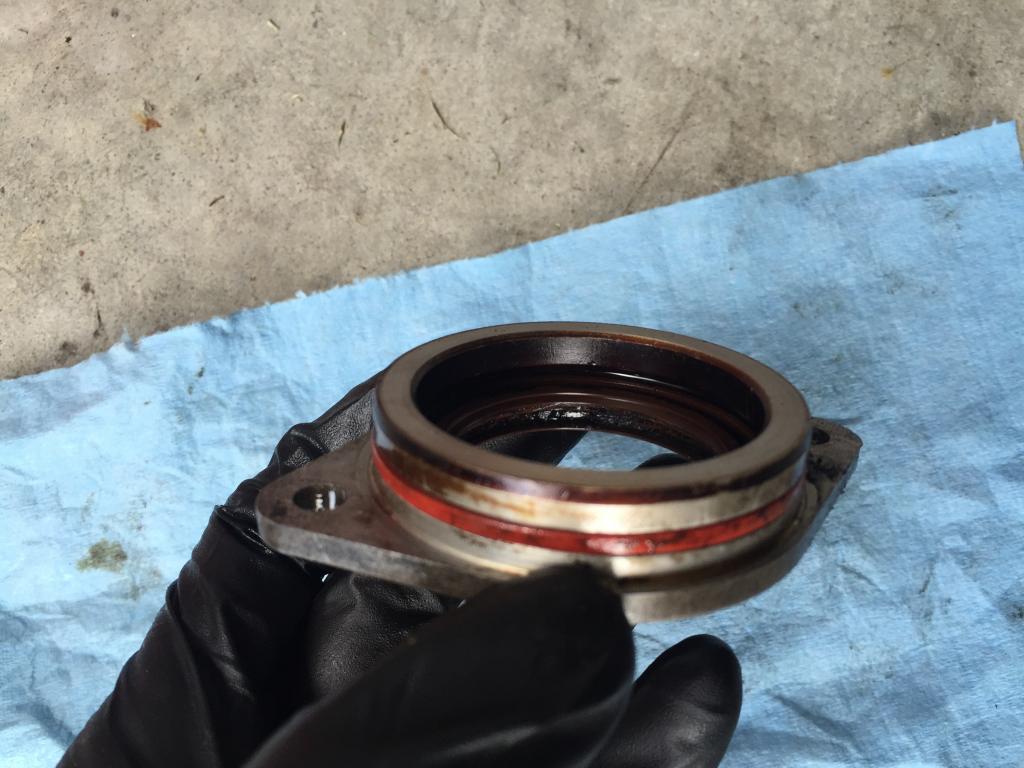

                      OK so 4 months later, i'm finally doing this job. I have a question that is some what puzzling.
                      Part #8, the O-ring seal...as I'm taking everything apart, the engine actually doesn't even have part #8? is this even possible?
                      I put in a new camshaft seal part #5, does O-ring seal #8 go AROUND housing #4 (there was no seal there before), or does it go INSIDE the cylinder head, and then the camshaft seal housing butts up against seal #8.
                      AGAIN...when removing everything, o-ring seal #8 is not found. I don't know if this job has been done before and the previous owner didn't put it back in or what.
                      Thanks in advanced!

                        Looking at the diagram it should seat on part #4 - between the side that's facing the engine and the engine. Maybe the previous owner didn't put it there, which would explain your huge oil leak =)
                          Actually...the diagram shows no information that the o-ring seal is seated over part #4. I think that it actually goes inside the cylinder head and that the o-ring seal seats directly behind the . If it's seated over part #4, then it will get "smashed/squished" as the part is tightened on to the cylinder head.

                            The o-ring definitely seats in a groove on part #4. Use a light coat of engine oil and move the seal housing (part #4) back and forth slowly while using light pressure to reinsert it into the cylinder head and it will stay in place.
                            Double check to make sure that the old o-ring is not adhering to the inside of the cylinder head. As crappycoco said, if that o-ring was indeed missing that would explain a large oil leak.
