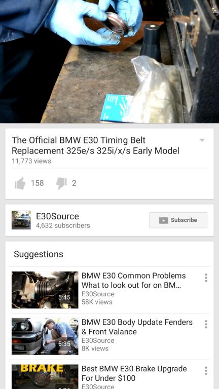

            So upon receipt of the o ring I was wondering that same thing. I am actually tackling this tomorrow and will have a better answer at that time. The o ring just appears too loose to fit in the guide snug but I haven't physically tried yet...that was just my initial impression. Check out this video on YouTube:
            At about 19:15 he covers the camshaft seal and o ring replacement.
            Here is a screenshot from video:
