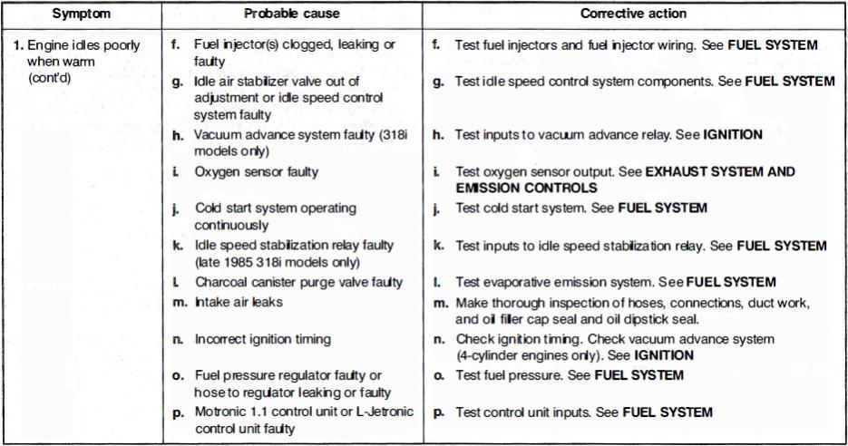

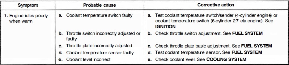

        • EatsHondas
          • Sep 2012
          • 404
          Go through this list.

          • Peace_Power
            • Jul 2014
            • 77
            Thank you, this is awesome!
            On the first list:
            Is there both a coolant temp switch and sensor? I've checked the blue sensor on the thermostat housing and got normal ohm values at the ECU.

                  • EatsHondas
                    • Sep 2012
                    • 404
                    Not for your whip, only the 318's and M20B27 (eta/seta motors) have a switch. The B25 has what you tested, and the single prong sender unit that tells your coolant temp gauge what to display. The single prong does not effect engine behavior.
