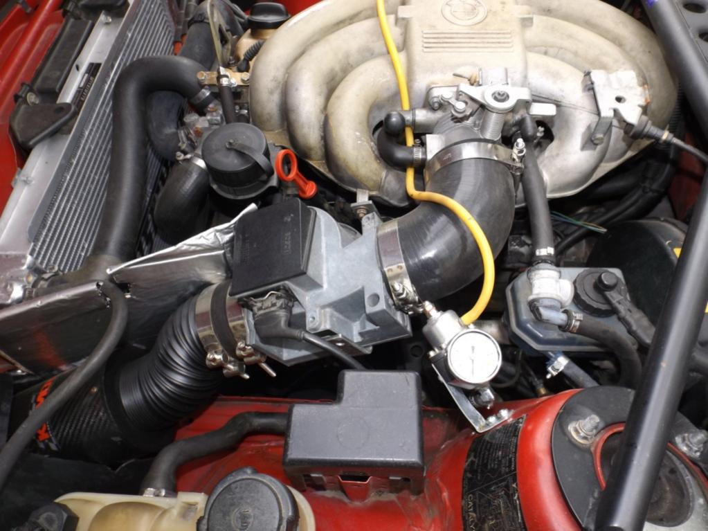

        Here's an IE on my track car. Of course I removed the power steering so there's no reservoir in the way.
