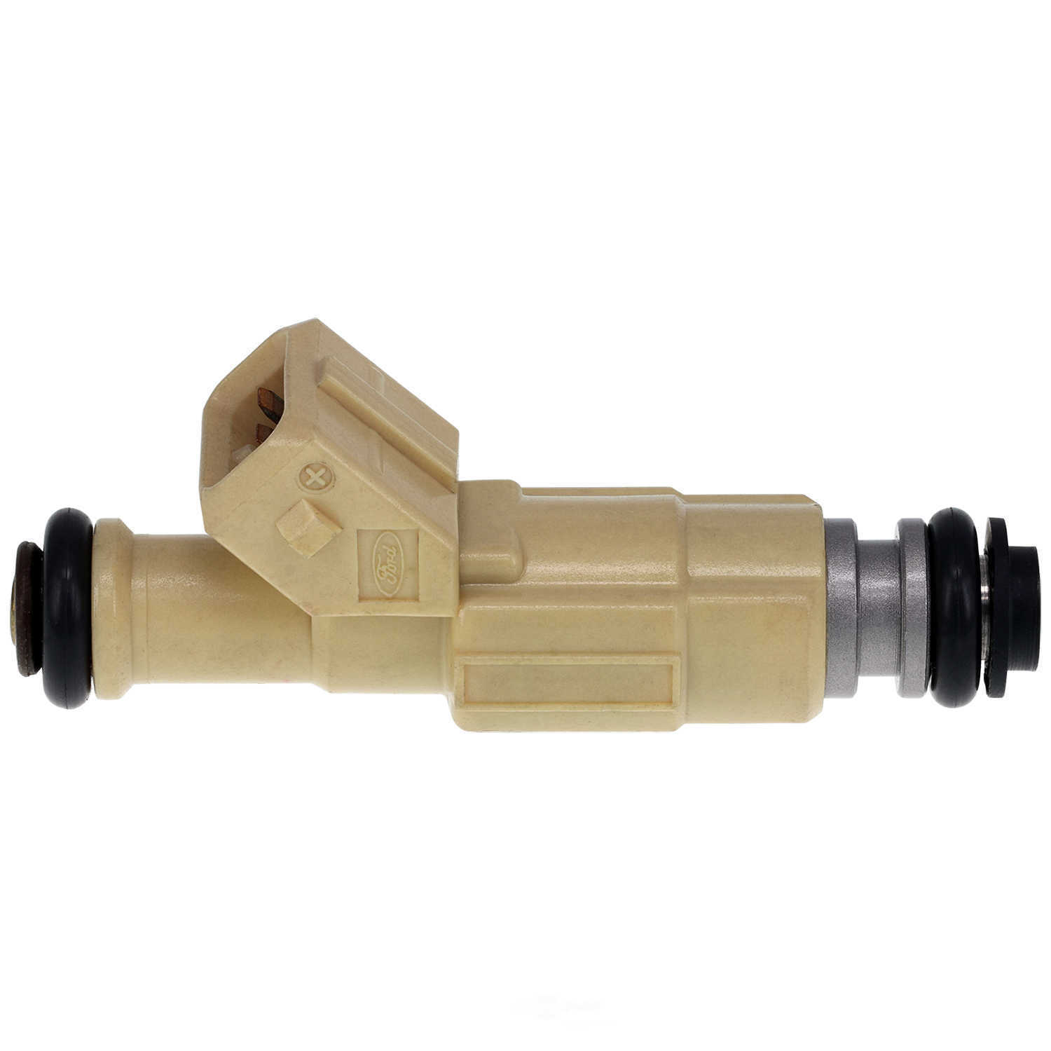

        Those are NOT stock injectors replaced with 4 pintle. They are an entirely different injector.
        More specifically, they are bosch 0280155771 injectors. Flowing 196cc @ 270kPa (18.7lbs @ 2.7 BAR). They come from a 1998-2000 Mercury Mystique, and I would HIGHLY recommend getting them from a different seller. One that doesn't attach BMW to them, such as this guy.
        http://www.ebay.com/itm/Set-of-6-Flo...7c0920&vxp=mtr
        I run them, they're great, HOWEVER I cannot speak for stock applications. I mated them up with a 2.5 BAR FPR from a 325e, a MAF conversion and a WAR chip, tuned them out and they're right as rain. (Didn't do much for tuning, it ran great with the stock 14lb map) INSTANT throttle response and no richy richness.

            No they are not. They are 17.5 lb injectors @ 3.5 BAR, 16.2 @ 3 BAR, and are VERY close to stock running an E FPR at 14.8 lbs @ 2.5 BAR.. Stock are 14.1 lbs @ 3 BAR
            If you really want to get Gen III OP, and not have to deal with anything else, go with bosch 0280155847 or 0280155969. Otherwise, go simple and do m50 4 pintles at with an E FPR, which I would recommend if you're already confused.
