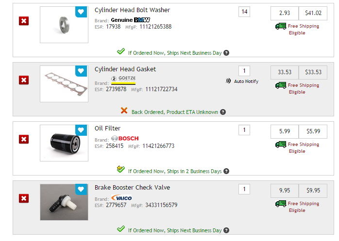

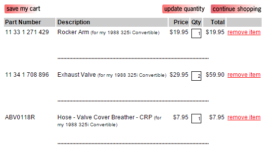

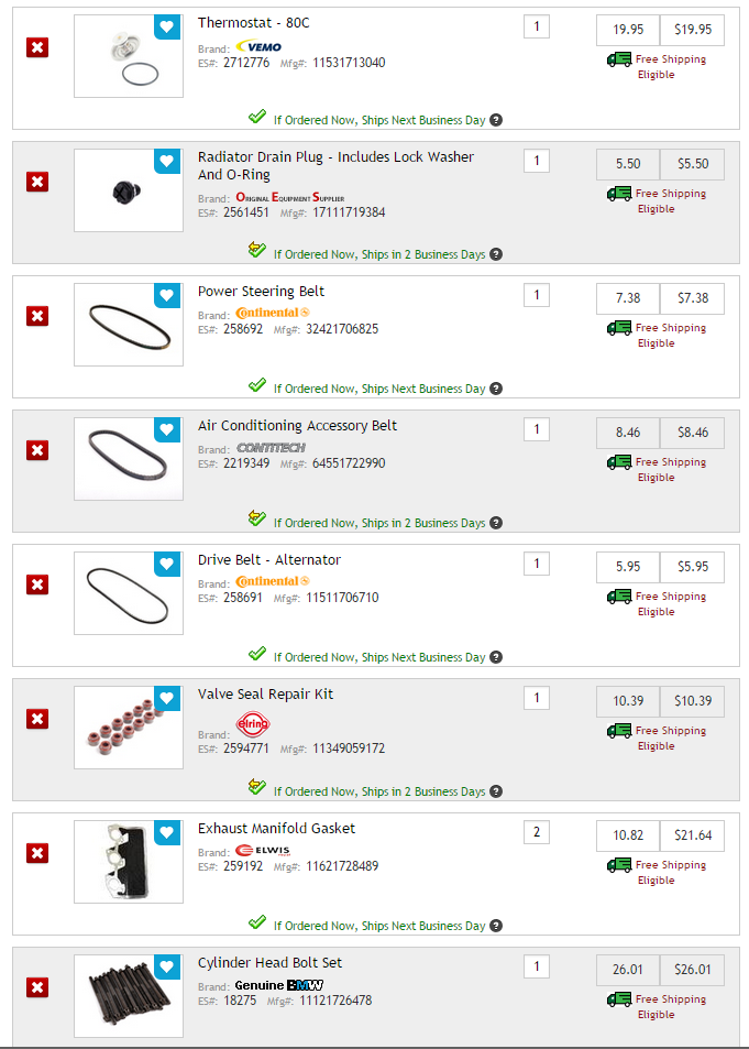

    Anyway, here's the big list I have so far of things I need and some questions that I really need answered from some of you smart guys out there. If some people can go over the stuff I have and let me know if I'm missing anything that would be so awesome because I'm stressing over this big time and I have no idea what I'm doing.
    1. Do I need new head bolts and washers (the washers cost more...) or can I reuse them as long as I put the bolts back into the same spots?
    2. Should I order a new rocker arm and valves or can I find some used ones and where would I find those (or i'll just ask on the forum) because I would really like to save some money on these (broke college student).
    3. Should I bother with replacing all the valve stem seals or only for the bent valves? I've been reading up and it looks like quite a bit of work to actually do it right and carefully.
    4. Is there ANYTHING else I need? The rocker arm broke and I don't know if I need to replace anything else with it like an eccentric or valve guide or plug (I don't know what any of this stuff does).
    Currently totaling out to around $430 without coolant and oil that I'll have to change. I will be resurfacing the head.
    Thanks for any help in advance.

          The bolts are torque to yield, so they need to be replaced. Get a few extra - technically, TTY requires one smooth motion, so you want a few spares around. I'd call the washers optional.
          Also, get a Genuine BMW head gasket. You may find that Genuine parts are cheaper from one of the dealers.

            +1 on getting the head checked before ordering any parts for it. A used head might be an overall cheaper option if you're already having to replace rocker arms and valves on yours.
            You can reuse the 14 head bolt washers. No need to order those.
            I don't see the rocker shaft plugs (x4), cam seal housing o-ring, rear heater pipe gasket, intake gasket set, exhaust manifold copper nuts (x12), breather "bitch" tube o-rings (x2) or thermostat housing gasket on your shopping list.
            Always install a rebuilt head with fresh gaskets and seals all around. And if any of the heater hoses or the throttle body heater hoses look questionable, there's no better time to get at them.

              The washers are plain flat steel so, use them again and you do not need to replace the tension spring bolt.
              Yes to all the other suggestions

                  You still want to get it tested, decked, grind the valves and seats and replace the valve stem seals. Anything less is begging for a redo

                      Ordered the parts. I went ahead and got the cylinder head gasket kit so I know for sure everything is in there (NOT THE REINZ, RELAX). Much thanks to everybody for helping me out. Now I gotta learn how to change valve stem seals.
