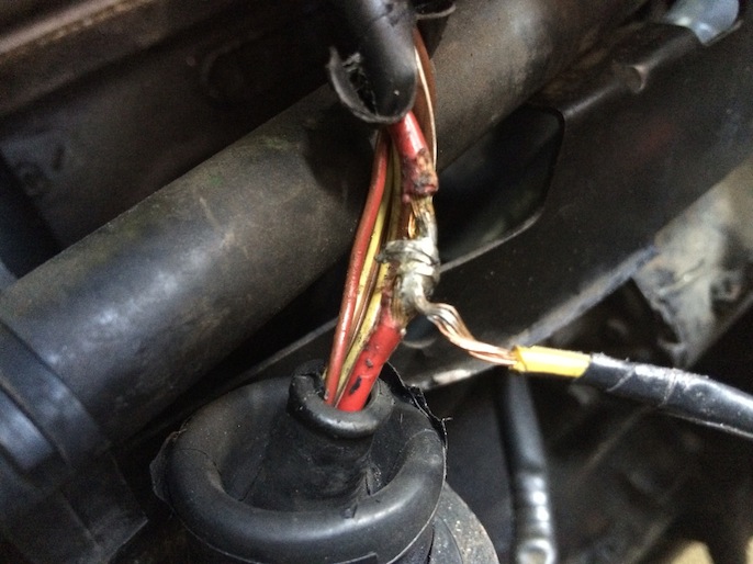

                          Pull the rubber boots off the c191 connector and inspect the wiring on both sides.
                          • unitt01
                            • Oct 2014
                            • 513
                            Yooooo... I did have a wire that was cut with only electric tape on it and I had to splice it back when I put everything in. :( It might have gotten loose during the process. This might be the problem.. Will check it tomorrow for sure. Thanks for this suggestion man!!! :up:

                            • unitt01
                              • Oct 2014
                              • 513
                              Woooow... It was the c191 connector... PO had soldered the top of the wire connecting to another one and there's about 3 small individual copper wires that didn't get soldered in with the rest. Ugh so unlucky that I didn't see that. The only splice I saw was on the bottom that was kept together with electric tape...
                              Tried to splice it back but the wire is too short now.. :(
                              With that said does anyone have an extra c191 connector ??
