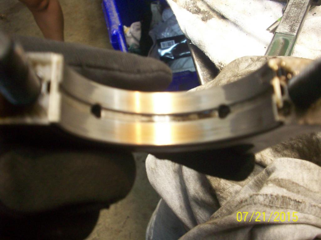

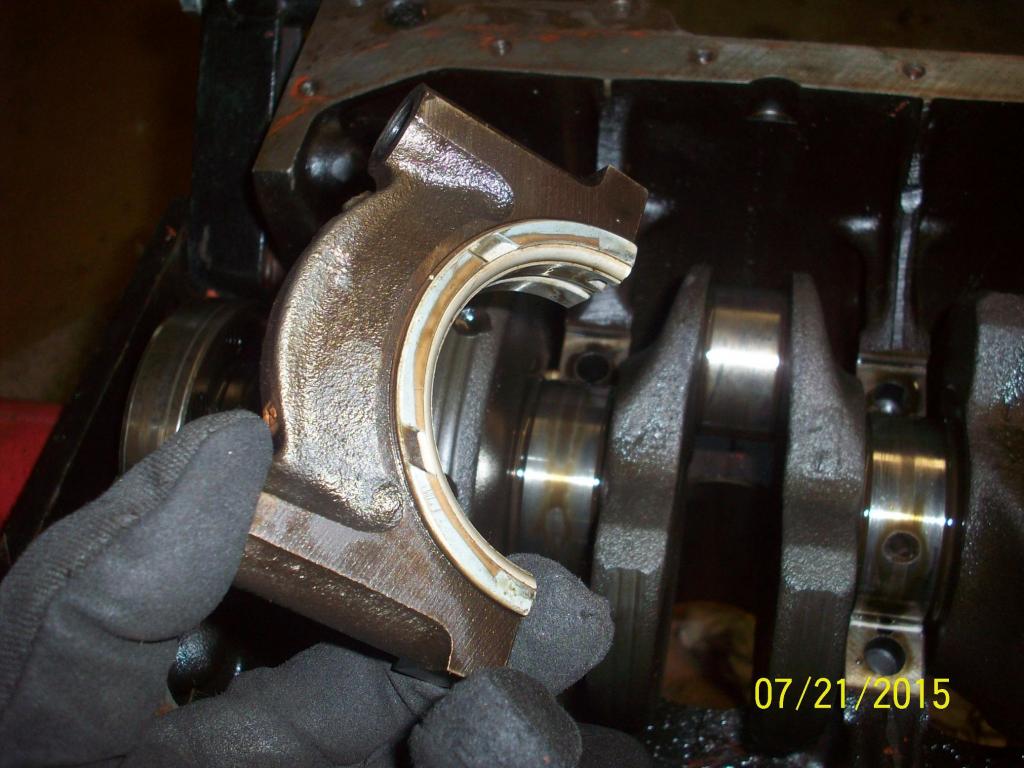

    For fun (and education) I tore apart an old E30 engine and here is a couple of pics of what I found.. (175K miles)
    Note - What you see is the metal wearing down and the copper showing (not a reflection) - This was the main bearings and pic #2 is the thrust bearing-
    Funny though I suspected that the rod bearings would be worse - but the main bearings were.
    If you let it get to the death rattle - then catastrophic failure may happen.. Why do you think the main bearings are going - the miles?
