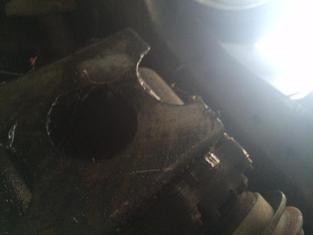

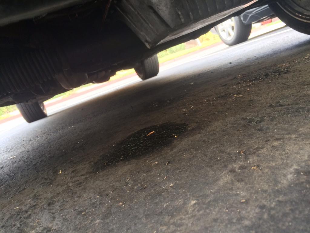

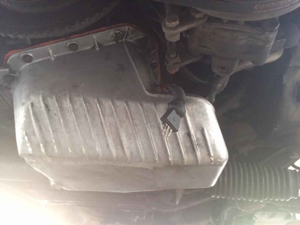

                  attached a few pics. hope this shows you what i mean

                    Your oil spot does look like its right below the sensor mentioned above. When mine went bad I was able to unplug the wiring and oil dripped out of the wiring too. Oil even dripped out of a crack in the casing of the wire elsewhere to make it look like I had another leak. New sensor during my next oil change and a new wire connector and I was good to go.
                    Instagram: Reichart12
                    • BMWManiac
                      • Dec 2010
                      • 1091
                      That is the connector to the oil level sensor....take a paper towl and dip it into the spot and see if it is oil or coolant. If it is oil, there are plenty of spots that could leak it on the m20. You need to clean it well, and then see where it comes from. Being in front of the motor, could be all the way up to the valve cover, oil pan gasket (I see enough RTV there)
