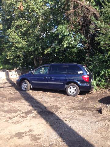

      Ouch
      When I was living in Philadelphia I was also a victim of a smash grab with the family minivan... except they stole the whole damn thing! Showed up 4 months later trashed
      I feel your pain! Glad to hear you had everything backed up at least.
