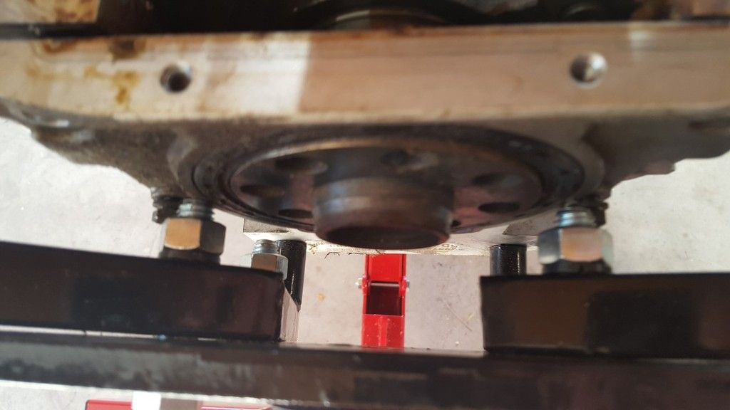

            M52 Teardown
            Alright, time to extract the 84mm stroke crank from our M52TUB28. Shop us ready, tools are ready. Looking forward to finally making more progress.
            Here's the unsuspecting donor block on our new electric hoist. Don't worry. Those cargo straps are rated 500lbs each.
            Engine transferred to the stand.
            Here's why the block was free. Broken engine mount.
            Cover removed. Cams exposed.
            Pulled the cams and holders pretty quickly. They're in good shape.
            Next we pulled out the valves and springs. Damn. Reasons not to do a 24 valve build. Replacing them with HD springs would be $$$$.
            Used this handy tool to pull head bolts. Had to go buy star sockets.
            Head removed. Lots of nastiness going on with one set of valves.
            First piston looks pretty nasty as well. We don't care. Not using it anyway.
            Ugh. Piston sludge.
            Got the oil pan off
            Rest of the bottom end oiling gear
            Our first setback. The crank pulley "jesus bolt" stubbornly resisted the 700 ft-lb air impact wrench. Time to get the 10 foot breaker bar. It can put 2500 ft-lbs on any damn bolt. Used a chain wrench to hold the pulley in place.
            Crank bolt came off easily with that setup. No drama. 1/4 turn to break and impact wrench for the rest.
            With the pulley off we could get to the timing chain covers.
            We can finally see the crank!
            Except the stupid engine stand is blocking removal of the flywheel side cover.
            Got that resolved and finally ..... pulled the crank. Total time less than two hours. Time to tackle pulling Das Beast engine.
            First time to grab some lunch. Check out the great sign at a local sandwich shop. ;-)
