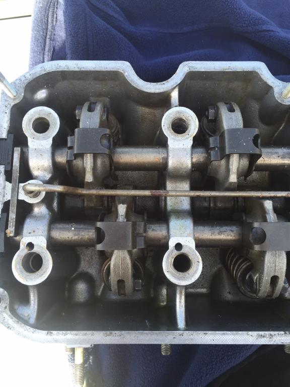

    so, I just bought a seta head off craigslist and he not knowing it was a seta said it came off another guys 1989 bmw. and here are so pics

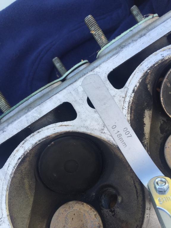

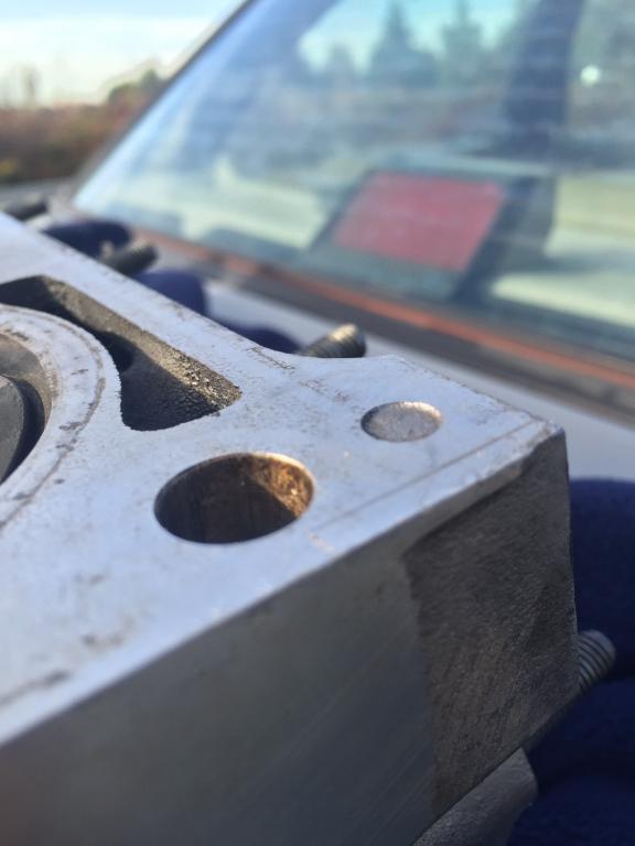

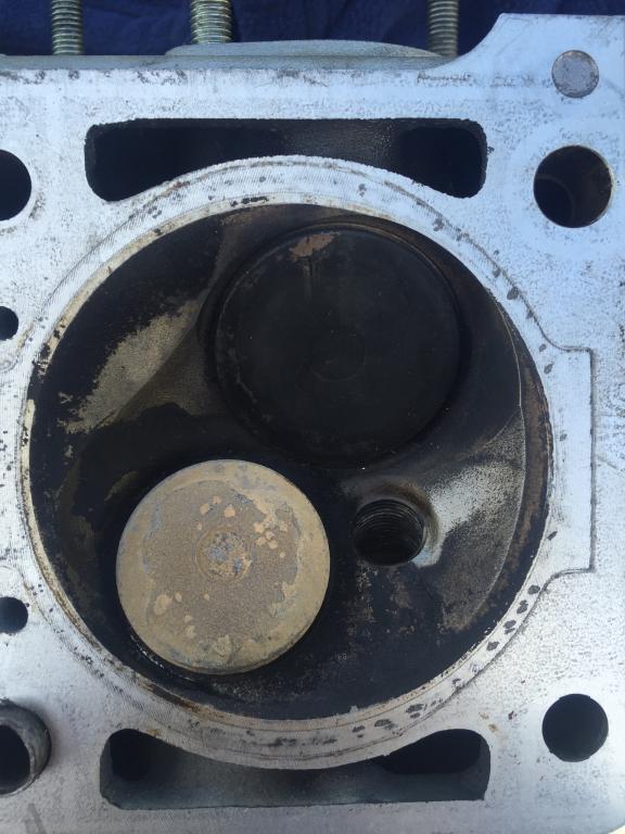

    I feel like this is almost worn down to the max, please let me know asap if its still good to use.
    this is where Im kinda of concerned. the feeler gauge went through easy

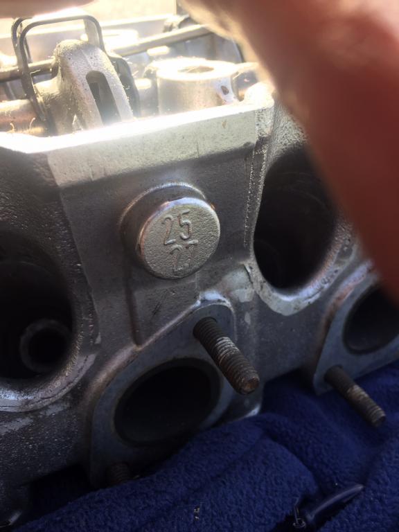

    so if its a super eta head do I need special wiring?

    What makes you think it's worn down? Dimples are still visible. Are you saying its warped? Might want to crack test it.
    Ditch the cam and single valve springs they are junk
    • wolverine_sr24
      • Nov 2015
      • 68
      the dimples looked pretty bad and I'm going to machine the head and do a port job before. I'll do a diy thread on the build soon, I'm thinking of a 540td cam, or is there better?
