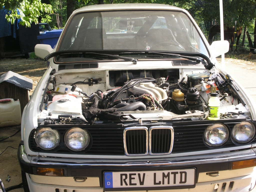

    I just got done the intake side of my new head. Waiting to hit the exhaust til next time at home. I guess it doesnt matter too much since I still have yet to see the cam from the group buy.
    Old and improved:

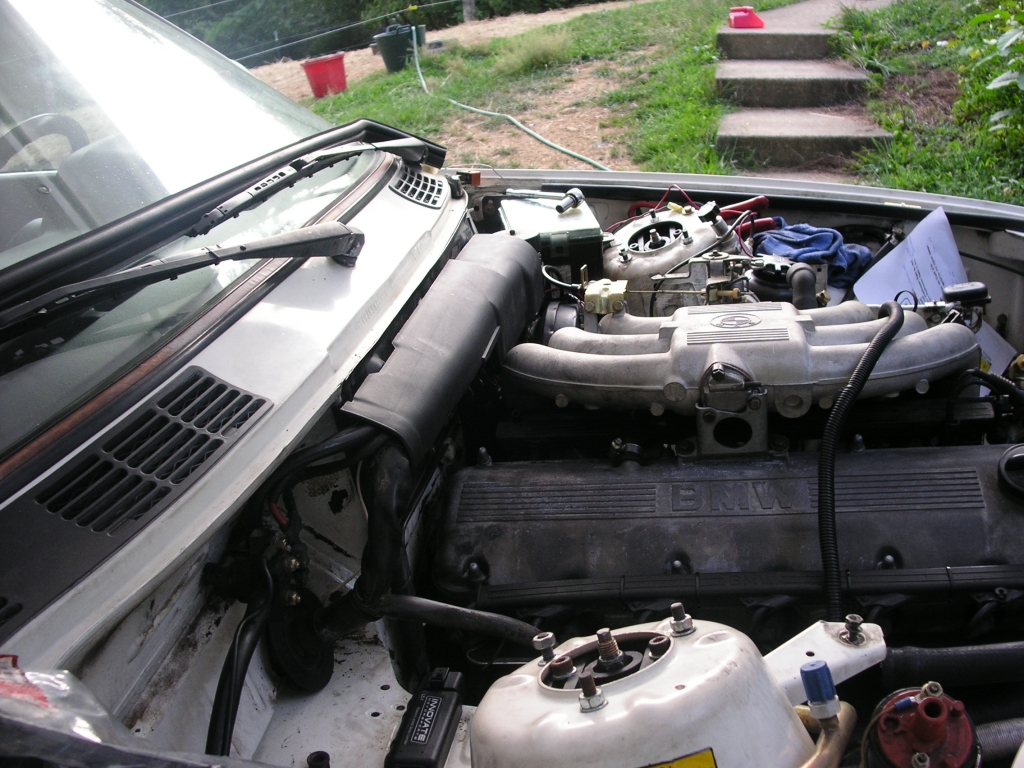

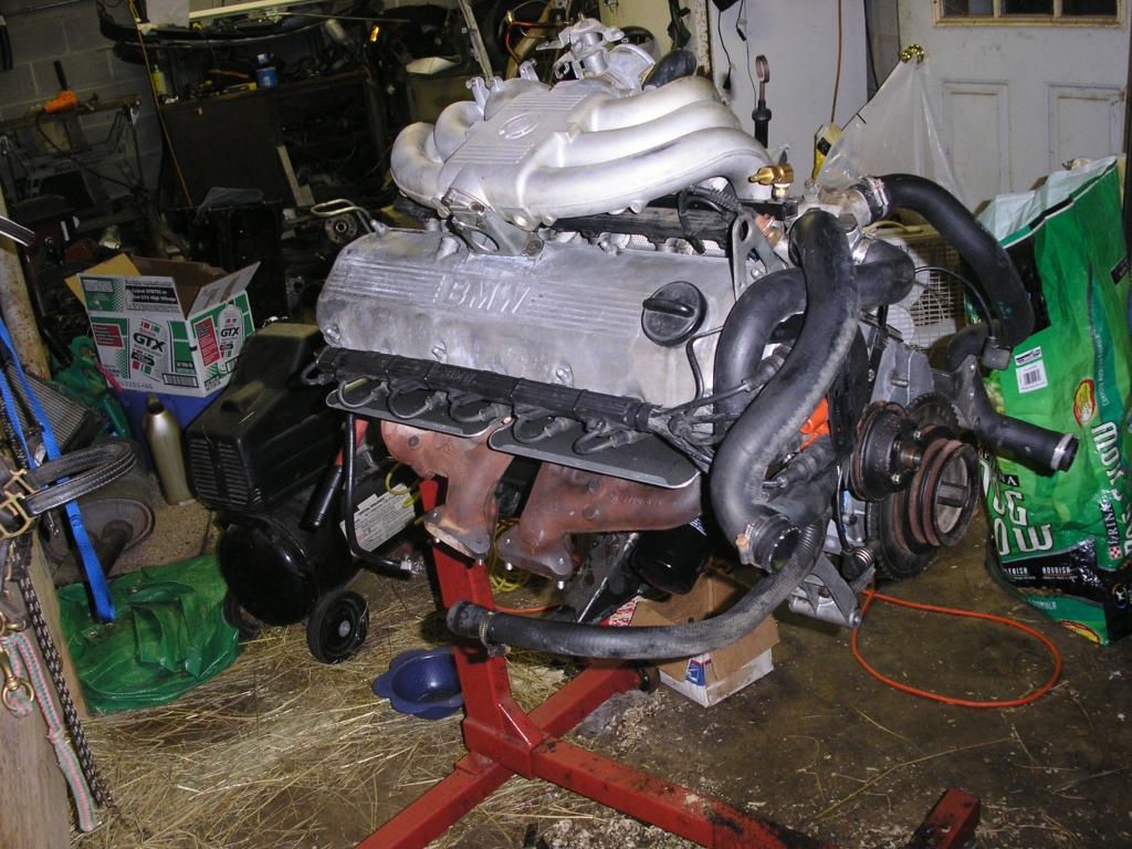

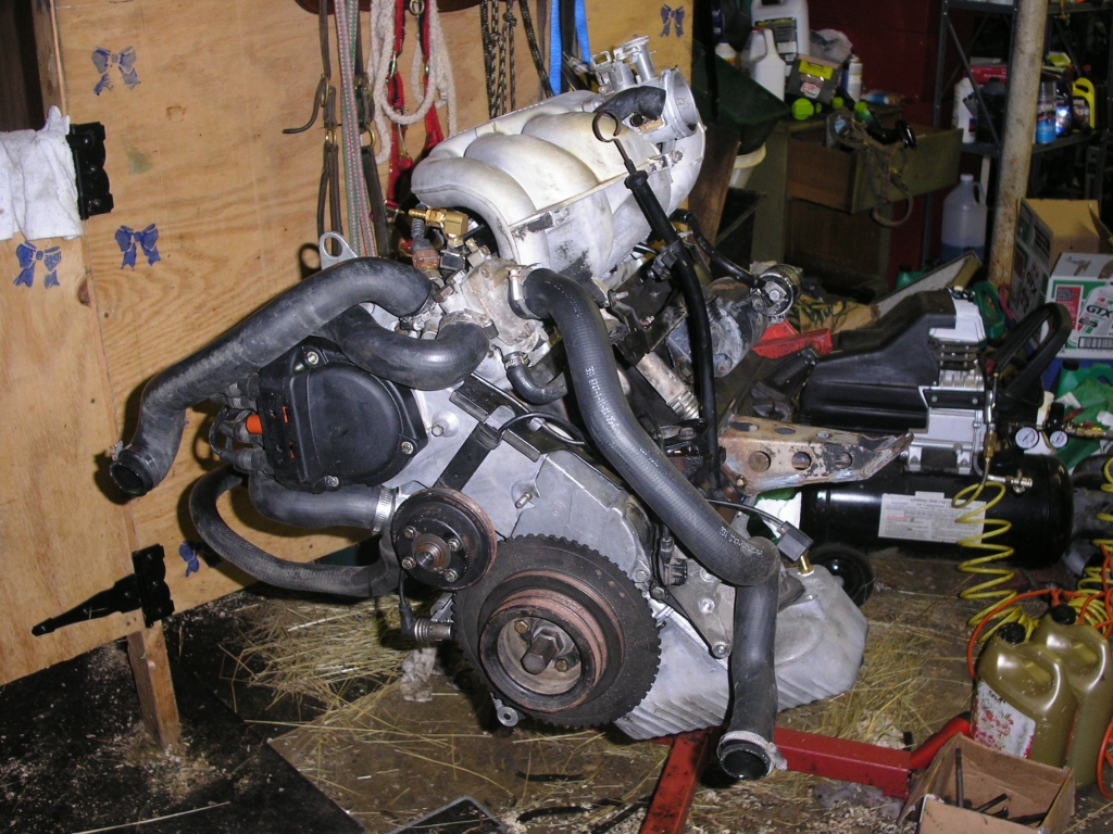

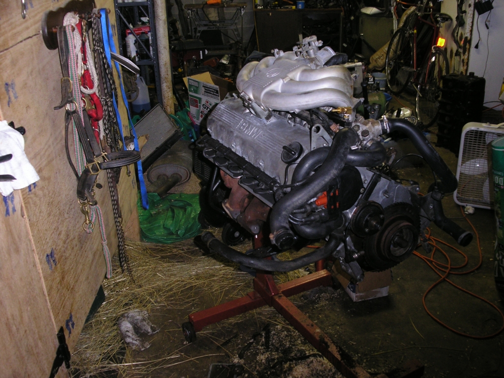

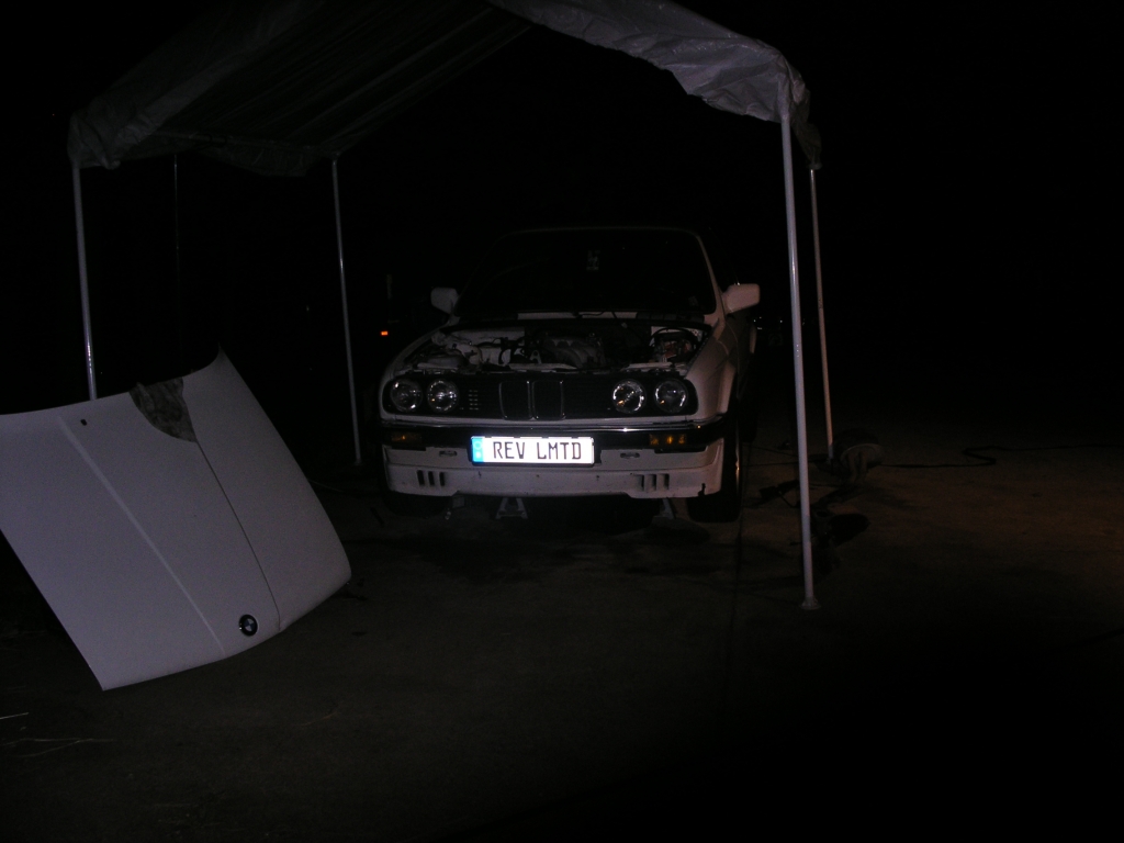

          Here are some pics of it all assembled. I would of painted everything but I did that before with the m30, and I didn't get all that much enjoyment out of it. I'll just hose down the engine every so often to keep it from turning black :p
          I started to tear down the car, the old engine will come out in the morning :)

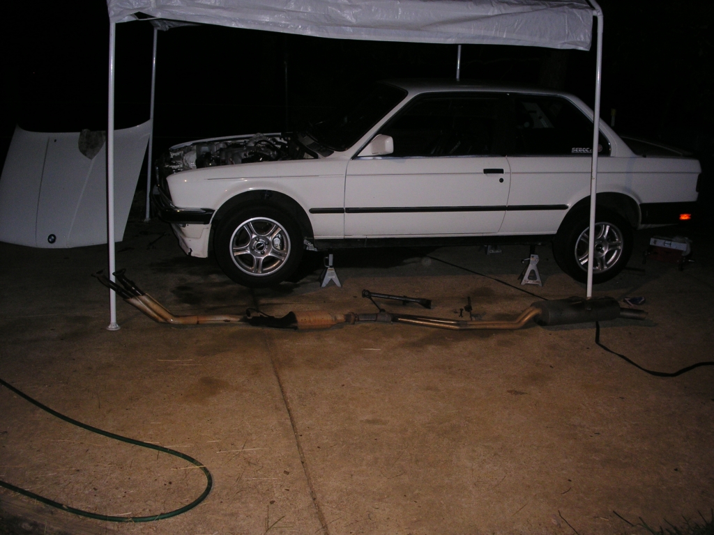

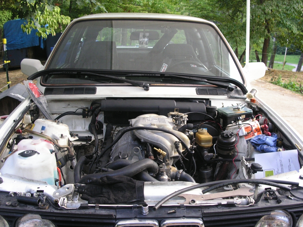

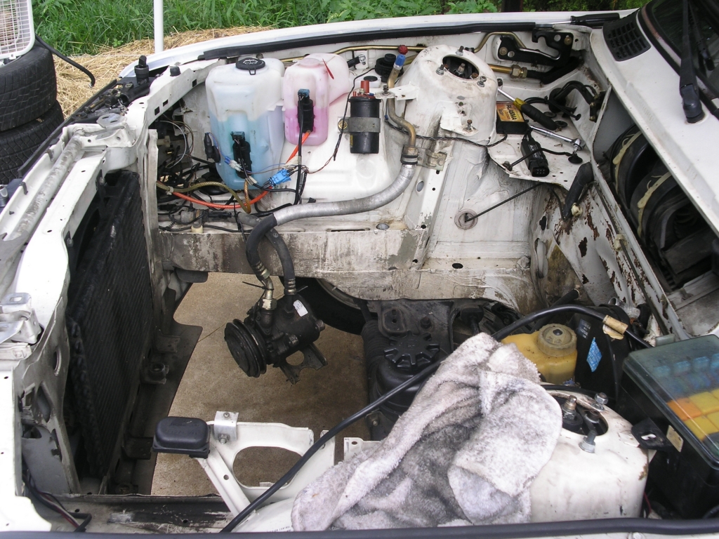

                    Got the engine yanked this morning, then just finished getting the new one ready to drop in, of course it just started raining, but looks like it will clear fast.
                    Empty engine bay
                    new engine ready to drop in
                    85 325e 2.7 ITB'd stroker

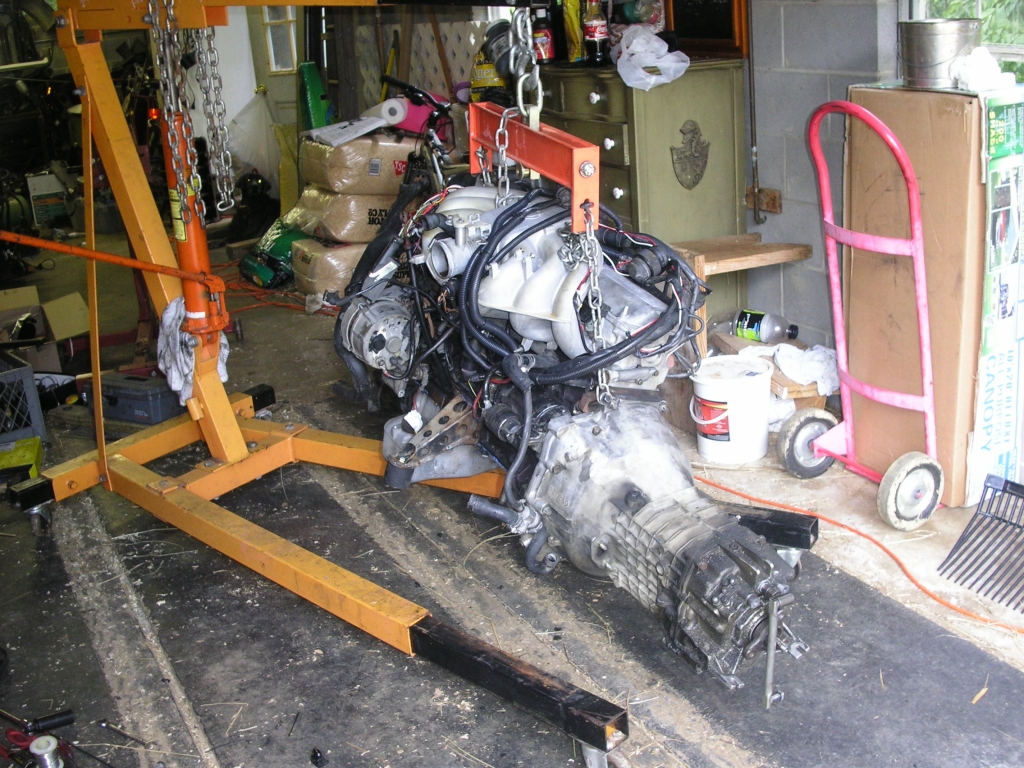

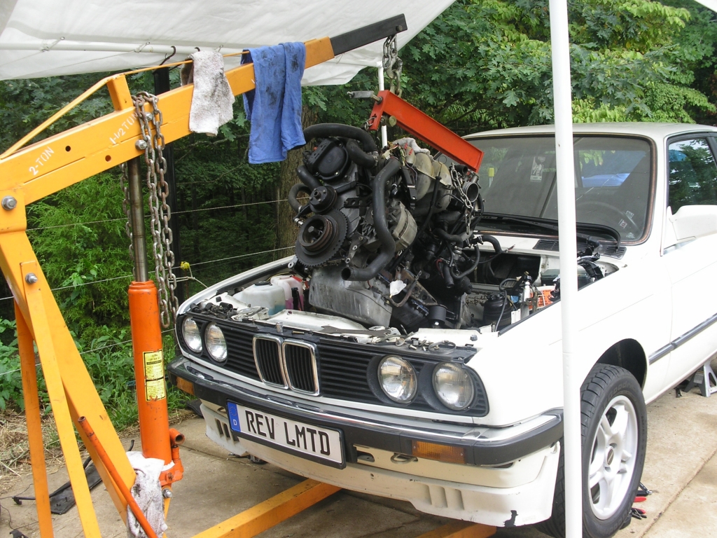

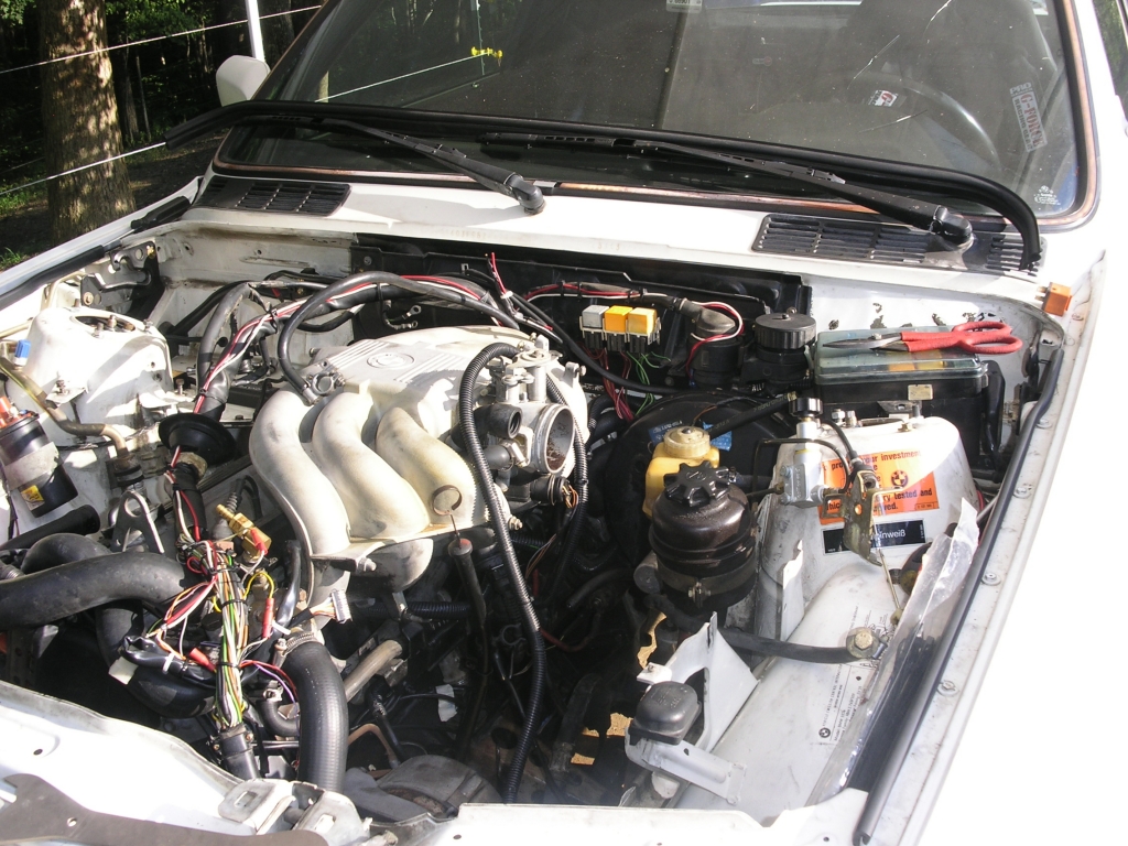

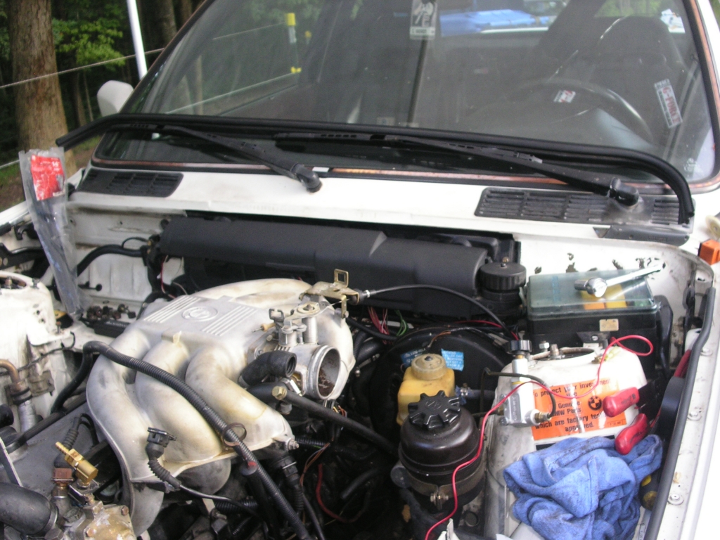

                              In she goes
                              Resting in place
                              Started snaking wires threw the m3 firewall cover
                              tidies up the wiring very nicely
                              I've got the battery tray cover, but I can't get it in place with the wires that run to the coil, and o2 sensor on the I harness. Oh well, I'll probally leave it off.
                              I should be able to start the engine up tommorow morning.

                                #45
                                She's alive, I couldn't believe how fast the engine started, I bridged the fuel pump relay to build up pressure, and with in just a few cranks it fired right to life. Was running exteremly ruff, but that was becuase I got the 2 lines on my Adjustable FPR hooked up backwards, It was running with 100psi of fuel in the rail for a little bit :crazy: I got those swapped around and it runs nice and smooth with a 700 rpm idle. The coolant system bled with no problems and I drove it around town for about 20 miles getting a feel for the new found power. I absolutely love it, chirps the g-sports in first gear accelerating no problem, and pulls like a train. The engine sounds so dang mean it's not funny, the thing revs like a bat out of hell. I have no idea what duration this cam is, all I was told is it's an aftermarker performance 325i unit. I haven't even hit the revlimiter yet as there just is not the need like the eta would always need to get moving.
