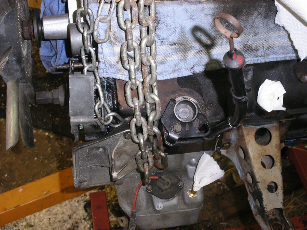

    Well - I took a look at a bunch of stuff. The oil doesn't seem to be finding it way down the front of my block anymore - so I'm really at a loss. There's a good amount of oil collecting on my bell housing and my tranny - but I honestly cannot find it's trail leading to there! There's a bit of oil around the silver gasket thing on the intake side of the block. I think it's the thing that the oil pump gear hooks to (the part that actually spins the oil pump). Was this supposed to be replaced - cause I never replaced a gasket in there? It's a little wet with oil, and I'm not sure why.

      that oil pump plug thingy has an o-ring, I would def. replace it with a new one. it's not too hard to get out either.

          So, that's still changeable? How would I get that thing out of there? Sure doesn't look very easy to remove...

            undo the 13mm bolt that holds the plate on above it, Then slowly pry around the edges with a flat head screw driver. It will slowly pull right out.

              yeah, you have to pry it out with a flathead. be careful not to get any metal shavings inside the block, you'll likely scrape some off the plug with your screwdriver because it's soft aluminum. you can also use it to prime the oil pump with a new motor :)

                  Picture of the oil pump plug thingy please.

                    Silver round thingy in that pic
