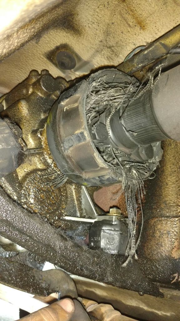

    Need help identifying which part this is at the end of my driveshaft, outer ring snapped off. E30 1987 325i
    Originally posted by Jromero1114 View Post
    [/IMG]
    guibo/flex disc
      First of all, the outer ring that snapped off is part of the vibration damper. I removed mine entirely with no ill effects.
      The frayed threads are from your flex disc/giubo. That needs to be replaced desperately.
      If your center support bearing has shit the bed as well, you probably have worn driveshaft u-joints.
        It also appears that the selector seal is leaking.

          Or output shaft seal. Might as well replace both seals when you do the guibo.
