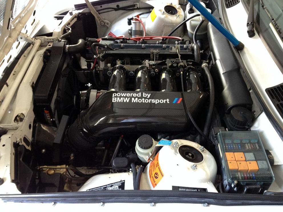

                I do realize that I am being illogical because I want something that does not exist. I have attached a picture of the airbox that I used on my M3. The reason that I refer to a German airbox is because I have seen firsthand the quality of the pieces. What I am planning to do is proceed in a 3 step process, dyno the stock airbox/afm, do the MAF modification based on the South African website, dyno this and then evaluate the cost/benefit of the RHD ITB's. I spent about $1800 on MAXX Alpha-N and the DTM airbox, gained over 20 hp, the throttle response and sound were incredible. If you had experienced this on one of your cars, you would understand why I would want to duplicate this.

                  the RHD setup gives way more than 20hp over bone stock probably closer to 35hp and that's on bone stock b25, the b28 probably utilises it even more. Compared to a what you're planning with maf conversion on a 3L you can expect 25-30whp more just due to the RHD manifold setup I.e fully tune compared to RHD plus full tune so the gain is the manifold not better fuel and timing as that's what happened on mine

                    So the complete RHD kit including airbox plus MAXX Alpha-N will run about $2000 USD. I can get that down to about $1500 by selling the parts that I have. Gaining an additional 30hp for $1500 is a no brainer.
