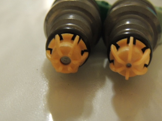

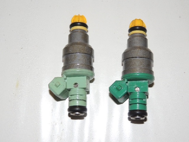

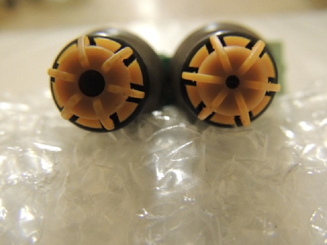

    I purchased 6 rebuilt M50 green top injectors for the 4 pintle upgrade and when I received them 4 were a light green and 2 were a darker green. I assume this doesn't matter but, three of the six have a smaller hole in the yellow "cap" than the other three. Does this matter? I have confirmed that all 6 have the 4-hole pintles.
    Why would all of the holes not be the same size?

    Assuming all the injectors have the same part number on them, you can get replacement caps for very cheap and match them up. Colors not matching is just an indication that the injectors were made in a different batch and most likely not from the same original car.
    • digger
      • Nov 2005
      • 6194
      i would always use same "looking" injectors and flow matched sets, they are kinda important pieces to the puzzle
