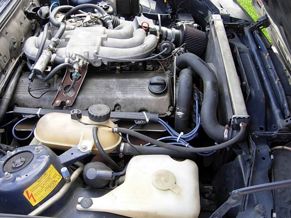

        Here's a pic of the 325e engine - you can see the plumbing on the passenger end of the intake manifold, the cylindrical idle control valve with the electrical connection, and the support bracket on the valve cover.

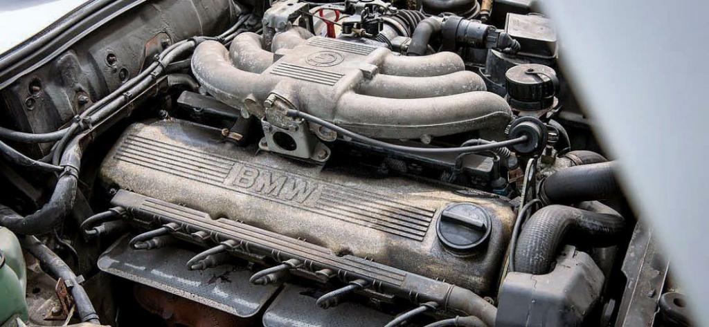

        Here's a 325i engine - different valve cover, bracket, plumbing, and ICV in a different spot. These pics don't mean they didn't change anything, and some of these things fit on both engines, but there would be no point if it has the i head on it. An e intake on an i motor would be ridiculous.

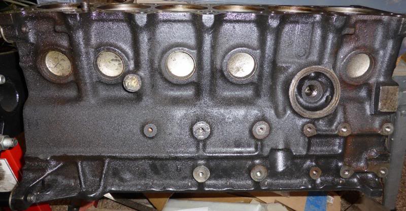

                  Thanks for that one. There are two pictures in there and my engine block looks like this one with the bolt holes directly under the oil filter adapter:
                  So I definitely have a 2.5 block then, correct?
