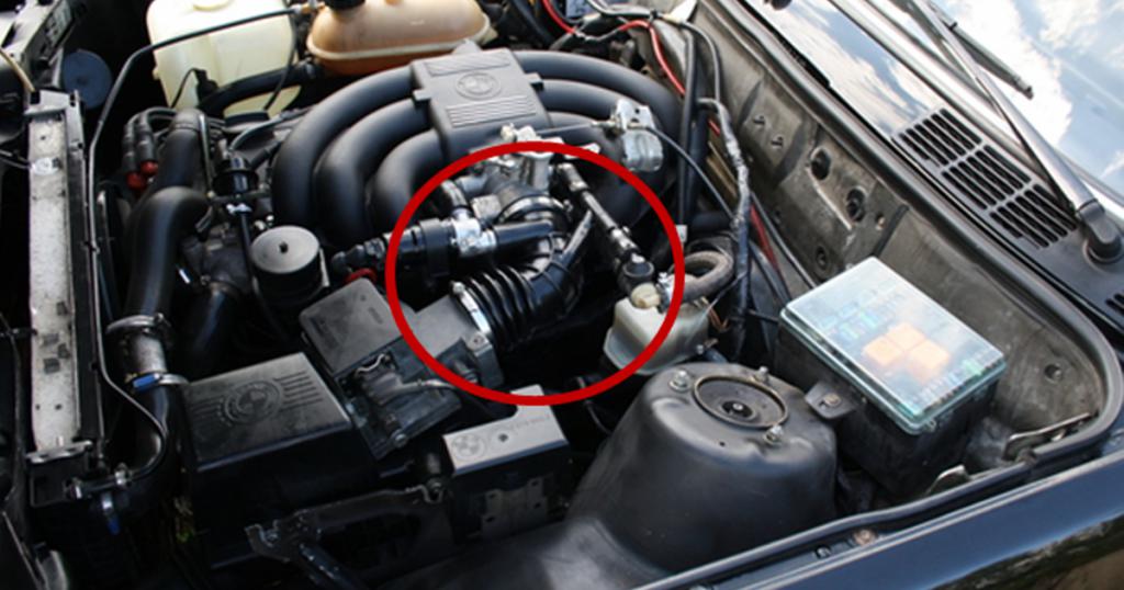

              Intake bellows or boot.....
              If it's original, it's probably cracked somewhere. Ours split in half when we pulled on it. This intake area has all kinds of fittings and hose clamps and gaskets where air leaks can happen. Just check all of it.
