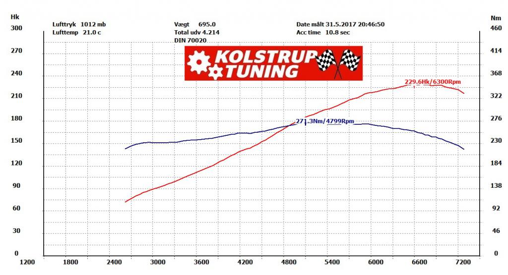

                      • Blach178
                        • Jan 2017
                        • 5
                        Originally posted by digger
                        i dont think you will make 200whp maybe ~190+/- unless you do some cylinder head work or RHD intake kit
                        sorry for interrupting.
                        Ive had the same crank in my engine aswell with low compression 8.8:1 pistons and there were no clearance issues what so ever. but well i didnt skim the block or head. so maybe thats why :P
                        but well now i got the new setup with det m52 84mm crank and the 9.4:1 prefacelift pistons in it block skimmed 0.5mm. Ported head, 284/272 cam, RHD ITB, bigger injectors and MSPNP2.
                        well im only getting 229/271 BHP :)
                        so my question what am I doing wrong ?
                        alot is talking about 200whp but im only getting 192WHP ?
                        Don't hang with your head, if you stand in a pile of shit :neutral:

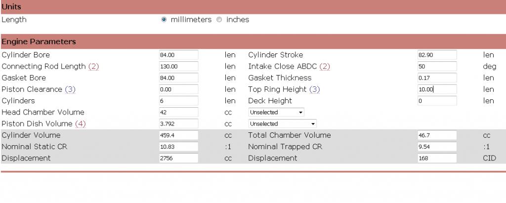

                          Here also my thinking (maybe stupid ) if with 84mm they advise to 0.5mm "clean up " the block , for sure with 82.8mm crank you must skimmed it for 10 + compression ratio.
                          Using Digger calculation :
                          135+34.2+(75/2) = 206.7
                          130+34.2+(84/2)= 206.2
                          130+34.2+(82.8/2) = 205.6
                          m52 84mm crank : 206.7-206.2 = 0.5mm
                          m51 82.8mm crank : 206.7-205.6 = 1.1 mm
                          Best is to do it and physically check all this, but i need to take a decision before buying parts :)
                            yeah i would have expected a bit more but it depends on the brand of dyno. nothing stands out as being off with the setup

                              yes, somewhere you need to account for the piston postilion in relation to top of block (deck clearance). if the piston is 1mm below the top of block or 1mm above you need to input this
                              head is closer to 40cc not 42 from what ive measured. the gasket bore is 85.5mm, stroke 82.8mm, inlet close 58, top ring land 7mm, not sure the piston dome cc for those pistons
