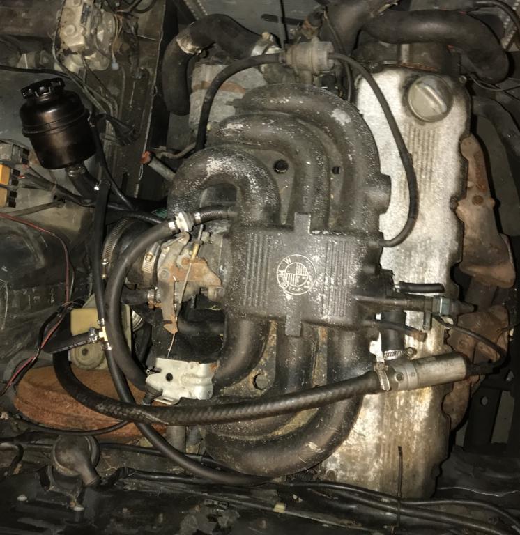

    So the previous owner of my newly purchased non running e30 said they did the heads. The car seems to be an “e” but i think it may have an “i” intake manifold. Is there a difference between the 2? Im trying to figure out if they did an “I” head swap. This car is giving me a headache lol. Pictures would help

    find the head casting number its on the intake side of the head
    I - xxxx885
    e -xxxx200
    I manifold is shorter fatter runners
    e intake manifold is longer skinnier.
    post a photo the intake is easy to tell

      It says 2.7eta so its an e right?

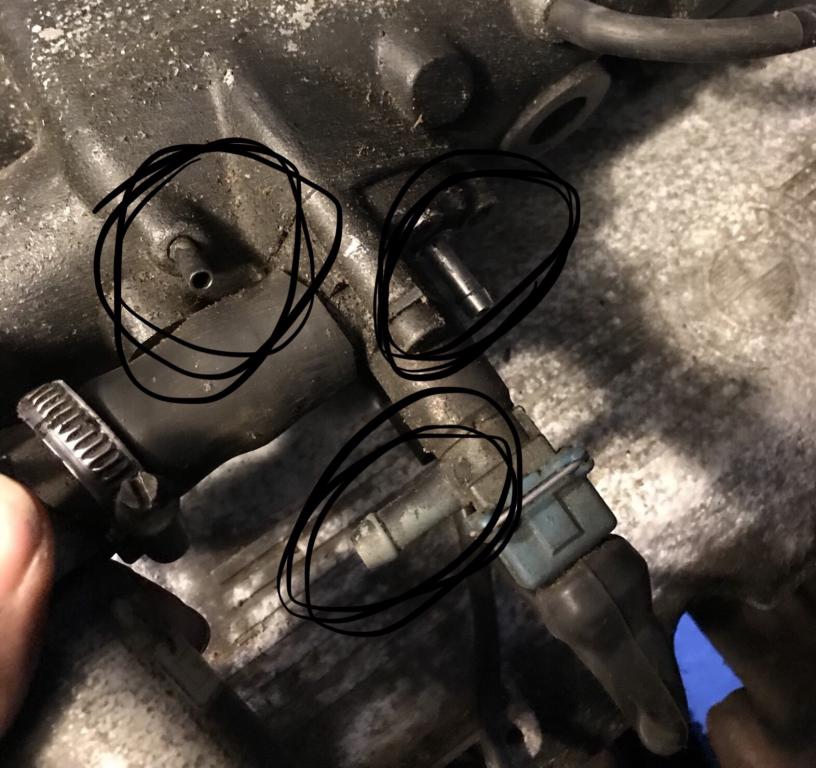

        Pics of manifold. Also why does my manifold have so many vacuum ports? Where do they go?

          The cold start fuel injector should have a fuel line attached, it’s the blue capped thing with the wire connected. There’s supposed to be a T fitting in the fuel supply line that is attached to the fuel rail, it’s at the back of the intake manifold near the fire wall.
          I will go look at my eta to see about the vac lines but I think mine is a bit different, it’s an ‘87
            So from what I understand I should put a T connecting a line from the fuel filter, the fuel rail and the cold start injector?
            • 325e '87
              • May 2017
              • 503
              Yes, that’s right for the fuel line.
