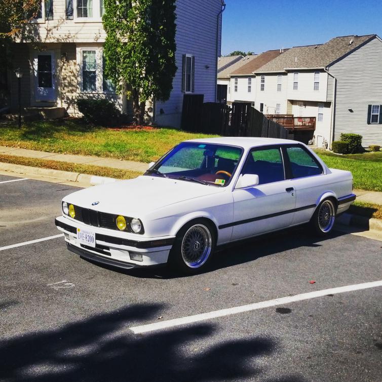

    So I recently got my 3rd e30 an 89 325i but it's been almost 10yrs since I've driven one and I have a question before I hit the search bar
    While driving I flows through rpms smooth but almost feels powerless and then all of a sudden at around 5500rpm it feels like it gets a huge boost of power,
    My question is, is that normal operation or should I start looking in to doing some repairs?

    All the power is in the higher RPM’s on an M20 but it should be smoother getting there. Could be an issue with the TPS switch or air flow meter. Maybe even a vacuum leak.
    Clean E30!
