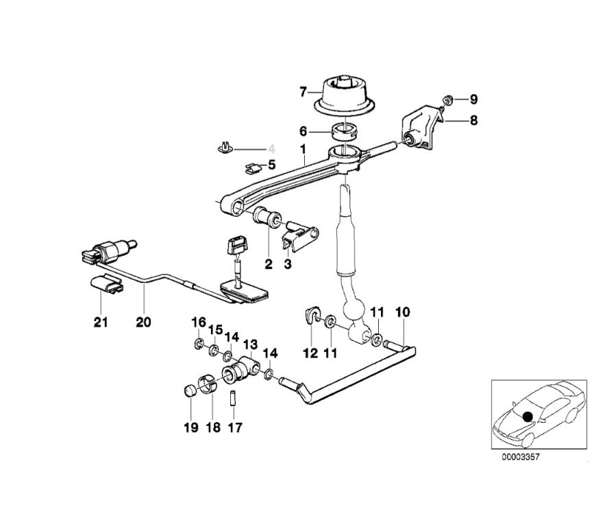

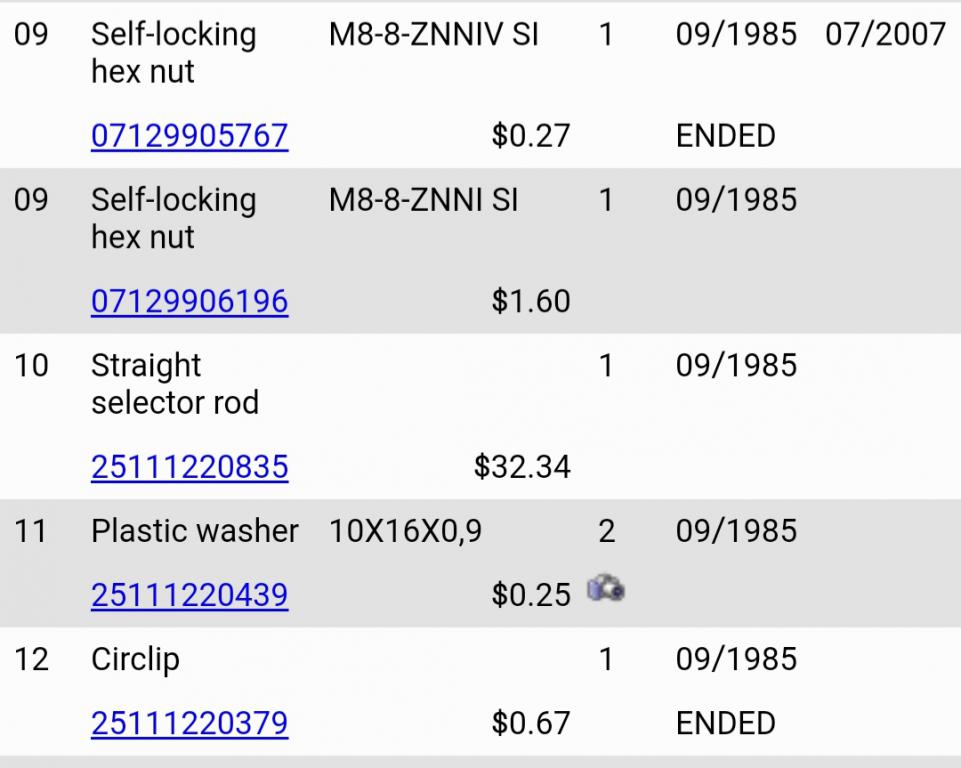

    To make a long story short, I need to know the length for part number 25111220835. Pics shown below in attachments pulled from realoem #10.
    This is for a selector rod found in my e30 touring. Engine is an m20b20 mounted on the getrag240. The reason why I am needing the length is so I can buy a DSSR to replace the selector rod. I may need to get one custom made.
    My understanding is that the standard length is 187mm when mounted on a getrag260 but due to the size difference between these two transmissions, it changes the selector rod length.
    I have searched the internet up and down and seems nobody has measured this before. If someone could measure it and upload pics that would be great.
