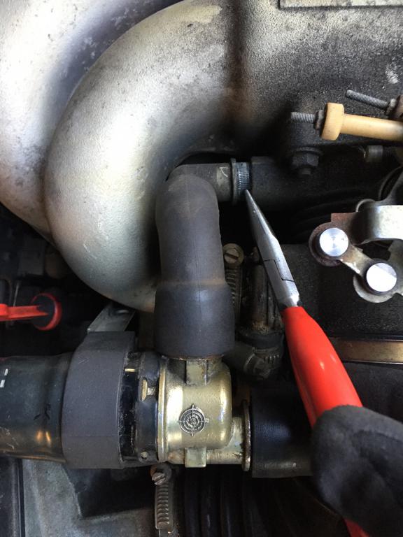

              If all fails, do a smoke test. There is an aluminum elbow going into the throttle body that can be loose when the engine warmed up. This causes a vacuum leak and a difficult start. A lot of people just use JB weld to seal up the elbow.
              • r-mm
                • Jun 2018
                • 203
                +1 - I just cleaned my IAV and found this little fellow entirely loose...
