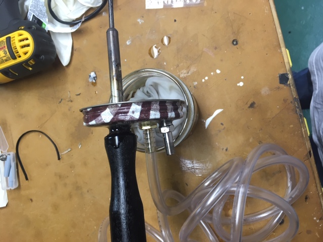

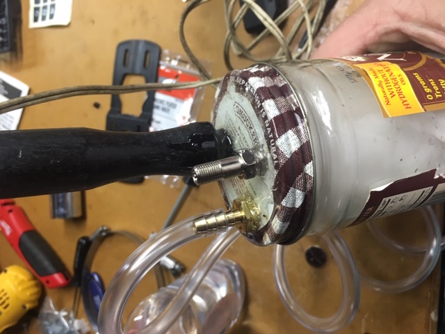

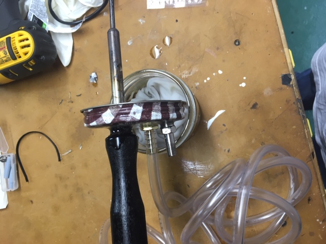

      Made a smoke tester out of a soldering iron, mason jar some clear tubing, a rubber glove and a bike pump....turns out my valve cover gasket has more holes than a gold digger’s diaphragm.
      Watch:

      • zaq123
        • Jul 2016
        • 1502
        Watch:
        https://youtu.be/OSJTHCKmVl8
        Obviously it is good that you found your potential oil leak area, Leaking valve cover won't give you any idle issues. Where are you pushing the smoke? You need to push it into the vacuum system, everything after TB butterfly. Unplug the crank breather hose at the valve cover and plug that hose if you are pushing the smoke into the intake box. Best way is to undo the intake boot and cap/plug your TB. Unless your IN valve seals are gone, you shouldn't be getting smoke under the valve cover when .
