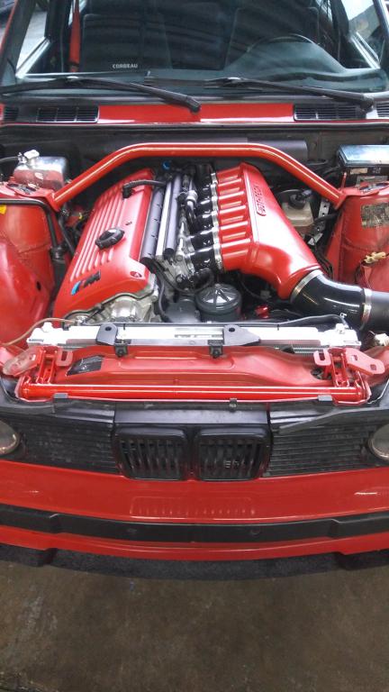

                        Correct. This also eliminates the expensive tee hose, as you can just use a regular hose to go to the expansion. For a really clean look, you could also block off the tee hose at the thermostat housing and use an early model water pump that has the spigot on the passenger side for the early model expansion tank - then use a trick aluminum expansion tank that sits on the battery tray. ;)
                        Edit: I did this recently on an s54 swap, would work just as well for an m20....

                          Now that is a clean engine bay
