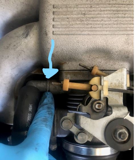

    I'm replacing the cracked rubber elbow that connects the ICV to my engine on a 2.5 liter.
    The metal joint that the rubber hose connects to on the engine does not seem to have a good seal to the rest of the intake. It pulls out easily.
    What type of sealant should I use to secure this connection?
    I see some residual debris on the joint that looks like it was some type of chemical/gasket/teflontape/sealant.
    -MC

    i used epoxy at the IAC fitting. sealed my vacuum leak for good.

      Isn’t epoxy for bonding vs making an airtight seal?

        i bummed it (epoxy)from my buddy.
        i dont think it ever needs to come out or move. airtight for sure.

          Looks clean. May give it a shot. Thanks.

            Permatex non hardening aviation cement seals anything where there isn't a huge gap and you can still dissemble it later.

              I used JB weld on all the press tubes on the intake and it's been holding fine. 3yrs of NA operation + 6 months (3,000 miles) on a turbo build.

                While I putted some high temp, gray color gasket sealant around the connection area, I don't think that should be a cause of vacuum leak.
