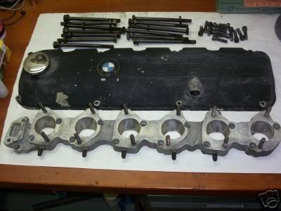

        Show me where to get an m20 triple side draft manifold.
        Easiest way would be to cut the standard manifold ~6 inches and weld some straight runners onto it. Then weld some DCOE/DHLA adapter plates onto each runner. Then you could drill some holes for vacuum if needed.

          I have no interest in running carbs on my m20. I eventually would like to run ITB's but I have no intestions of doing that much work for it. I have seen the m20 triple dcoe manifolds on ebay before. When I find one priced right I will get it and run ITB's from these guys: http://extrudabody.com/index.html First I will do this on my e21 with an M10 I am building. Dual side draft manifolds for the m10 are easy to find these days.

            TWM makes THESE .
            They used to offer carb manifold too but it looks like they sold the carb stuff to THESE GUYS .

              nothing for the M20 though :( I contacted pierce a few years ago and the only six cylinder manifold they had was for the m30.
                        went to google and found this in a for sale section of a forum after searching for "M20 DCOE manifold".
                        As for getting some carbs I'd suggest going to a junkyard and looking for some 240Zs or going to forums FOR cars of that type. You're bound to find someone on the boards who took on a project car they can't afford and need to make some money quick. Or if all else fails.... Ebay. They have plenty of Weber, dellorto, SU, and even some Mikuni carbs for a decent price.
