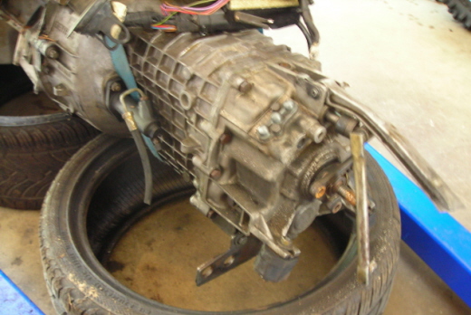

    are you asking if its a i or eta motor? i trans will have a pin at the rear behind the shifter, eta trans will have a odd bracket. i motors have smaller, less curved intake manifolds. etas have huge intake manis...i think, i might be backwards on that. pics could help.

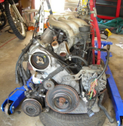

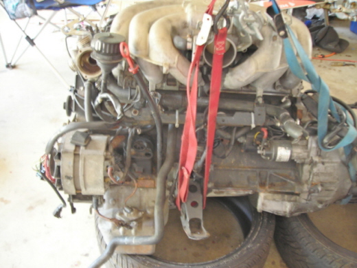

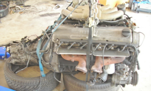

        Pics:

          Looks like an i, or maybe super eta. The eta engines have a roundel instead of BMW on the valve cover.
          • Jordan
            • 12916
            Everything I see is indicative of a m20b25, I engine.

                  Yeah. Looking at the fuel injector harness rail, I would say its 1989 or newer.

                    See that toothed wheel on the front? That means either SETA or "i".
                    Your intake mani looks "i" as well, and +1 on the late model fuel injector connector.
