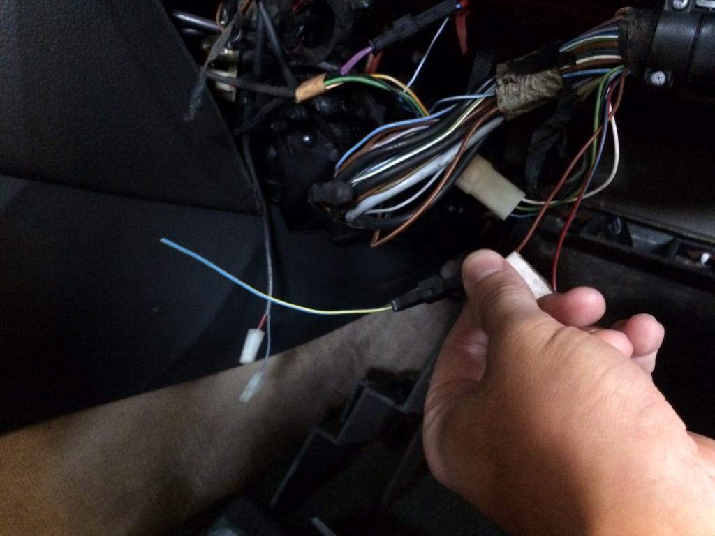

    Been doing some digging, and now after reading this post and its entire 30+ pages twice now, I still haven't found the definite answer. I'm concerned with the same issue that lateracer posted above back in 2010. I've got a near identical setup to his, '86 eta, swapped i head and all necessary parts, using an '89 i harness and 380 ECU, the harness c101 connector fits the body, but the pins don't match exactly. Many have mentioned it's "plug and play" but unlike a few success stories on here, I'm not "firing right up". Here is the engine harness with 12 pins, and the body side with 11 spots.
    Does something need to be spliced in here to get it to run? I feel fairly confident everything is connected correctly, but don't know what I am missing. When I turn the key I don't hear the fuel transfer pump, when I jump the fuel relay it fires right up, so pump is good, checked the relays - good, starter engages and engine turns over but it doesn't fire up. I've tried swapping the crank ps and halifax ignition sensor connectors, same results. There are a few wires near the ECU connector that I have no idea what they go to. One brown (should be a ground?) and the other blue/red. Anyone have an idea what these are for?
    If anyone who has done the e to i swap and encountered similar issues I'd really appreciate a point in the right direction. I'm so close!
