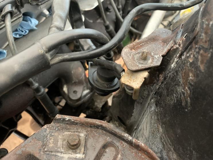

  • ASEHugo
    replied
    Originally posted by ForcedFirebird
    There's a 6mm threaded hole in the battery tray, worked for me.
    I ended up settling on this, using the underside of the rear coolant overflow tank mount. I wire wheeled and cleaned the bottom surface down to bare metal, mounted the cable to the bracket as usual, and flipped it over to mount it.
ID:	10064671 Click image for larger version
    Not sure why one of the pics is upside down, they were meh anyways but I hope they convey what my idea was. Thoughts?
    Leave a comment:
  • ForcedFirebird
    replied
    Leave a comment:
