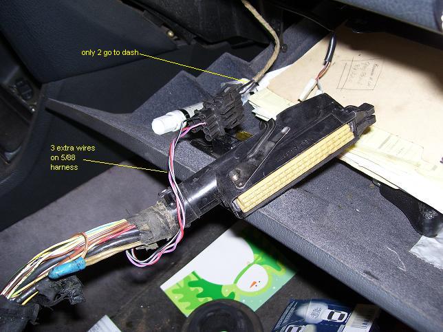

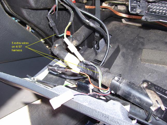

            A Concern
            Ran into a small problem...
            where the wiring harness plugs into the ECU there are some other connectors that split off and run into the dash. The one in the 5/88(the donor car) has 2 wires that run into the dash. The one in the 4/87(the recipient car) has 5 wires that run into the dash. Not sure what to do.
            Equal rights should be all or nothing, not picked and chosen based on what's convenient for ones personal agenda.
            • oldcarskickass
              • Sep 2006
              • 53

                the 87 harness has the c104 plug, these provided power to the ecu from the OBC fuel cut relay, the tach signal to the tach, and the fuel rate output to the OBC. On the 88 harness these functions are run threw the c101 round engine plug. So you either need to run wires from the round plug to the rectangular plug, or just use the 87 harness
                  Round plug to rectangular plug? More specifically, which wires to which wires? Or if using the 87 harness are all things gonna match up under the hood and with the 87 harness would i use the 87 ecu or the 88 ecu?

                    Ok on the big round c101 plug(main plug that connects the engine harness to the fuse box). You want to connect pin 7(green wire) to the green wire on pin #2 of the white 3-pin rectangular plug.
                    Pin 8 White/black to pin 3 white/yellow wire
                    and pin 9 black to pin 1 black.
                    Yes everything will plug in with the 87 harness, and you can use either ecu.
