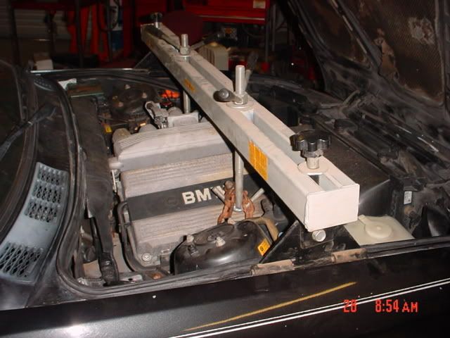

    First, support the M42 from above with a suitable lift or support, if you plan on doing this with your vehicle on jack stands I would suggest placing some 2x4 under the jack stands to give the vehicle some extra ground clearance. (Dont continue until the vehicle and M42 are 100% stable)

    Remove the motor mount nuts and raise the M42 off of the front sub-frame.
