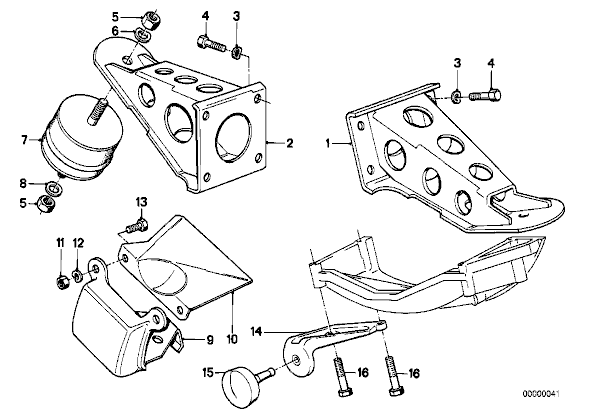

    What is #9 for? Mine was rattling around...and I blindly just took it off...

    That is the bracket for the heat shield, for the motor mount on the exhaust side.

      Heat shield for the motor mounts...

        Doesn't it get sanwitched between the motor mount and the subframe, It also has a heat shield on the exhaust side, to protect the motor mount. I left em' off when I did eurethane motor mounts....

          I guess I will put it back on - not need to melt anything. haha!

            Haha...I did the same thing puting my heat shield stuff back in today. Motor mount heat shield as everyone has said.
              Leaving the heat shield off, especially with urethane motor mounts isn't a good idea. The heat from the exhaust can melt the mounts.

                Hmm... Should I put that on?
                I have the e30 m50 motor mounts from AKGmotorsports, and my headers are heat wrapped...

                    Does it fit with the AKG motor mounts for the m50 swap? Anybody know?

                      i wonder why i had one on the drivers side as well, w/o the shield attached.
