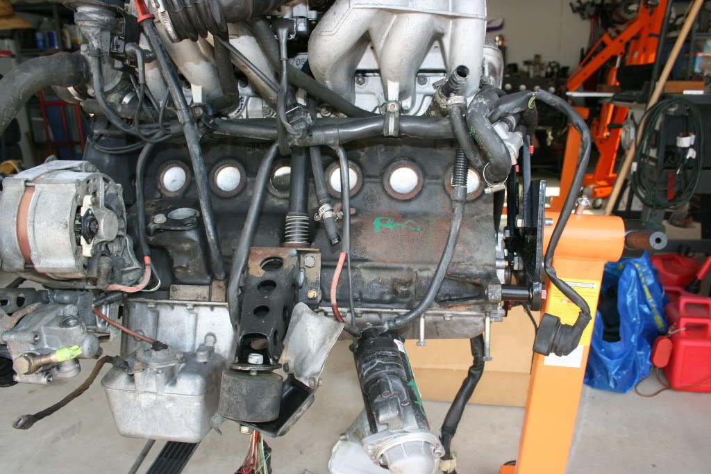

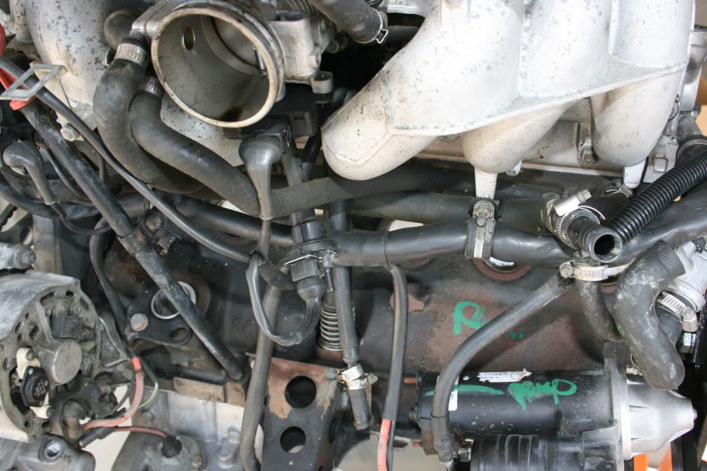

        The best I could think of is check someones car, but here are some pics.

          What are the ones by the diagnostic plug for? Are they for the CPS and #6 pickup?

            cps oil pressure sender
            Andy
            Edit: nevermind you are right
            did all this a couple days ago
            -Andy
            • h82crash
              • 127
              The two right below the diag are the cps, close one and the cylinder signal, far one. The oil sensor wire is the longest on the harness and wraps around the front of the engine next to the cps wire. The cylinder signal route over the top of the timing belt cover and down to the plug by the diag plug.

                What about the oil pressure switch? Where my alternator connections are it has just a 3pin connector coming out where the 2pin oil level sender one would be?

                    On my harness the oil level sender had the 2 pin round plug, It is the green and white wire you can see in the photo. Yes it comes out right where the alt wires are.

                      Yep I know, Every loom I have had, had only a 2-wire circle connector. The one coming out for this one is a 3pin rectangle one as would plug into the ICV or TPS etc. Weird.
                      • h82crash
                        • 127
                        Look closely at the pins on the connector, Are there two terminals or three? Check your dealer and see if any level sensors have this plug.
