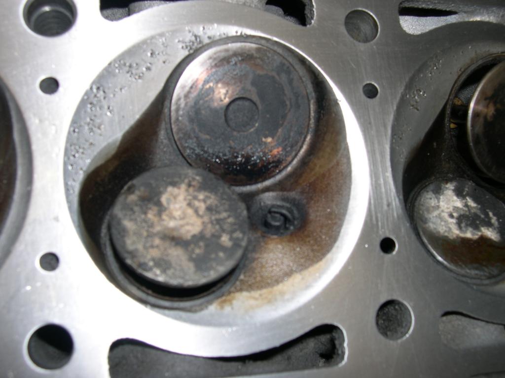

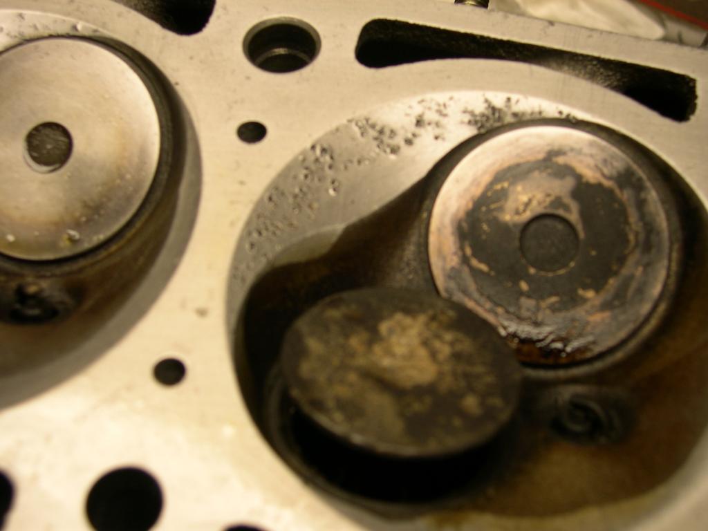

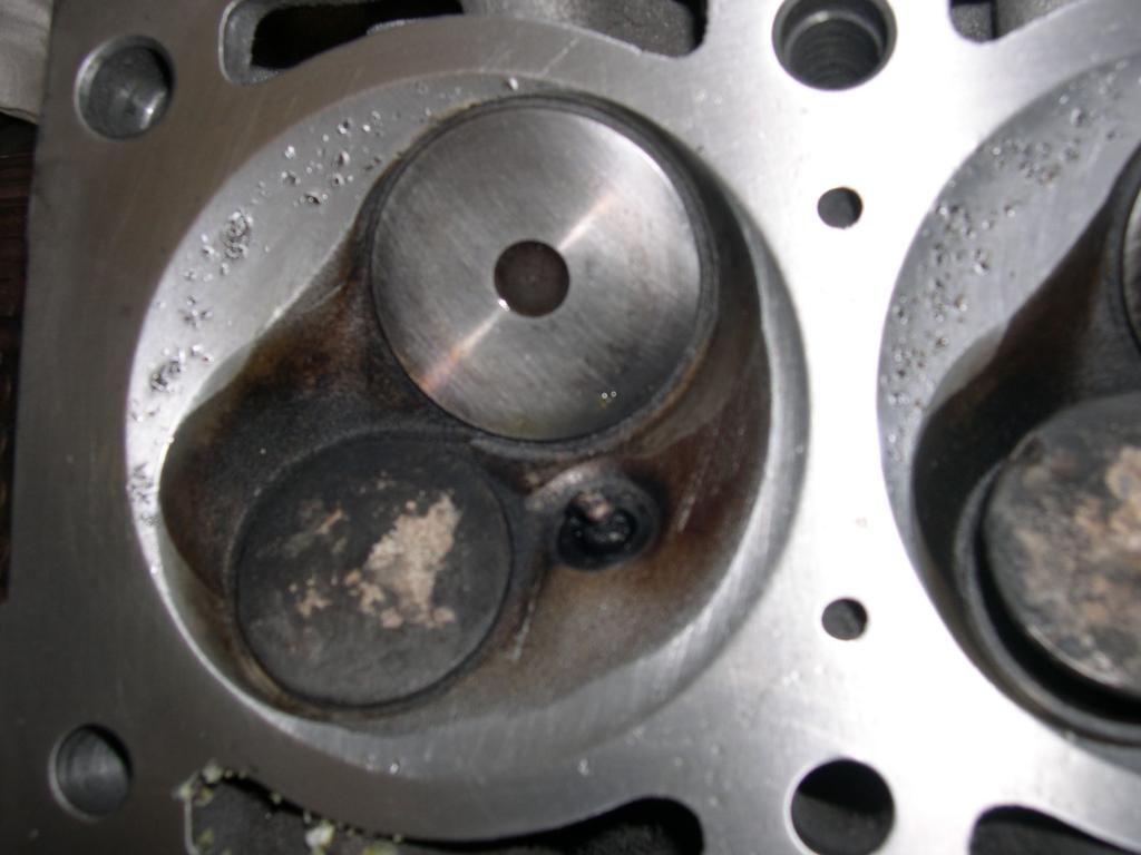

                        Here goes...Click image for larger version
Name:	e30 head 001.jpg
Name:	e30 head 007.jpg
Name:	e30 head 002.jpg

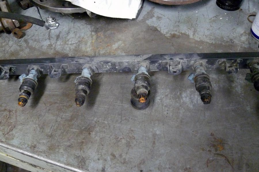

                            detonation. and because its not seen in one cyl is because it wasnt firing, or getting fuel, from the looks of those injectors.
                            • h82crash
                              • 127
                              That is detonation and what usually happens is the ceramic insulator breaks off the sparkplug and gets pounded in the head and piston. So...the spark plug didn't break in the one cylinder. That doesn't look too bad either, that can be smoothed out with a die grinder with a rotory Scotchbrite pad. The head I had was worse and I smoothed the sharp edges and she runs great. (2.7i build)
