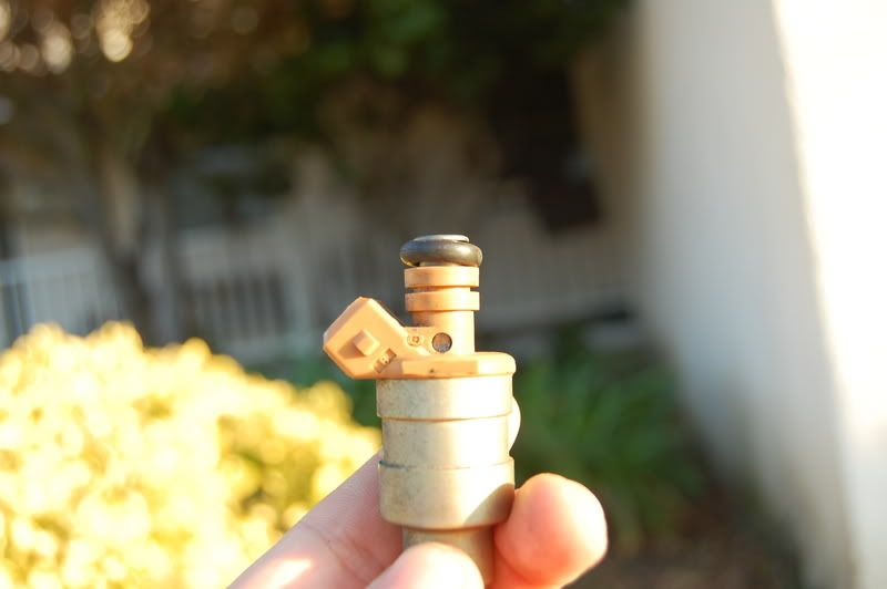

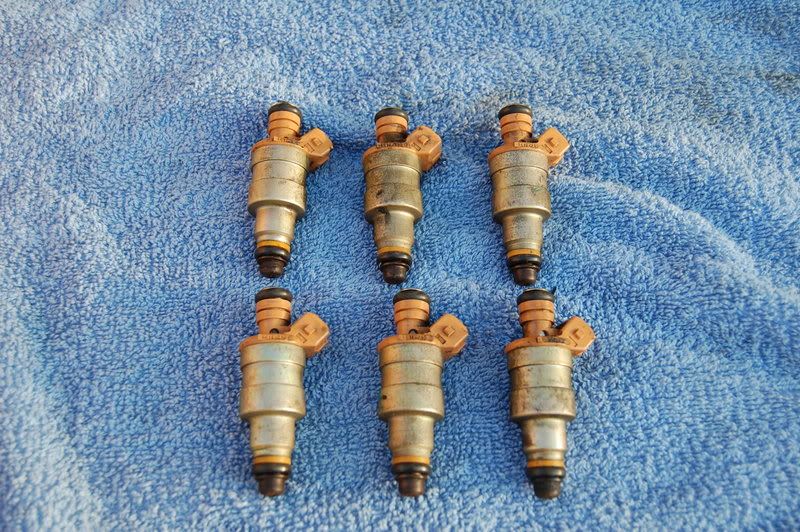

    So I pulled these injectors out of a Lincoln Mark VII with a 5.0 High Output V8. I cross-referenced the part # (e6te-a3b) and they came back as 19 lb. injectors, however they don't look like most of the ones you guys have. Is it an older design?

    they are 19's probably just and older design mine are exactly like that but instead of metal casing it has yellowish orange like that rest of the injector

      so are there any benefits to using the newer design?
      • nando
        • 34844
        yes, vastly better fuel atomization.

          hm, which ones have the best atomization? What do they look like? What year did they start showing up in 5.0's?

            look for injectors with 4 pintle holes. they all look basically the same on the outside though.
