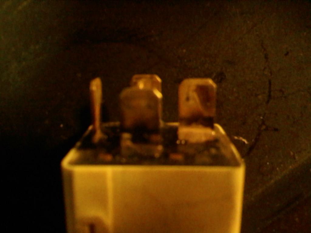

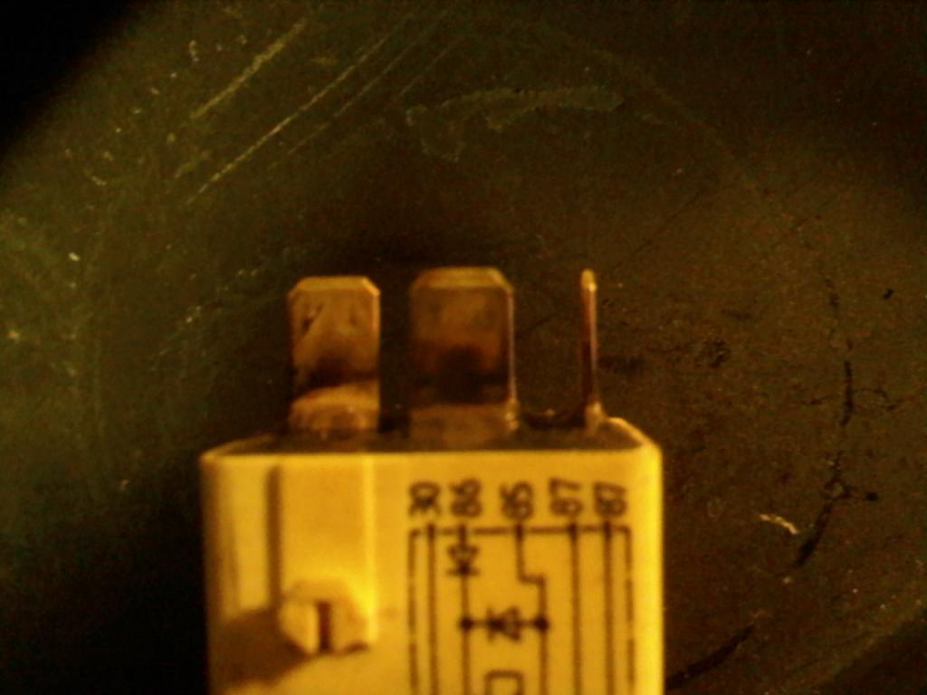

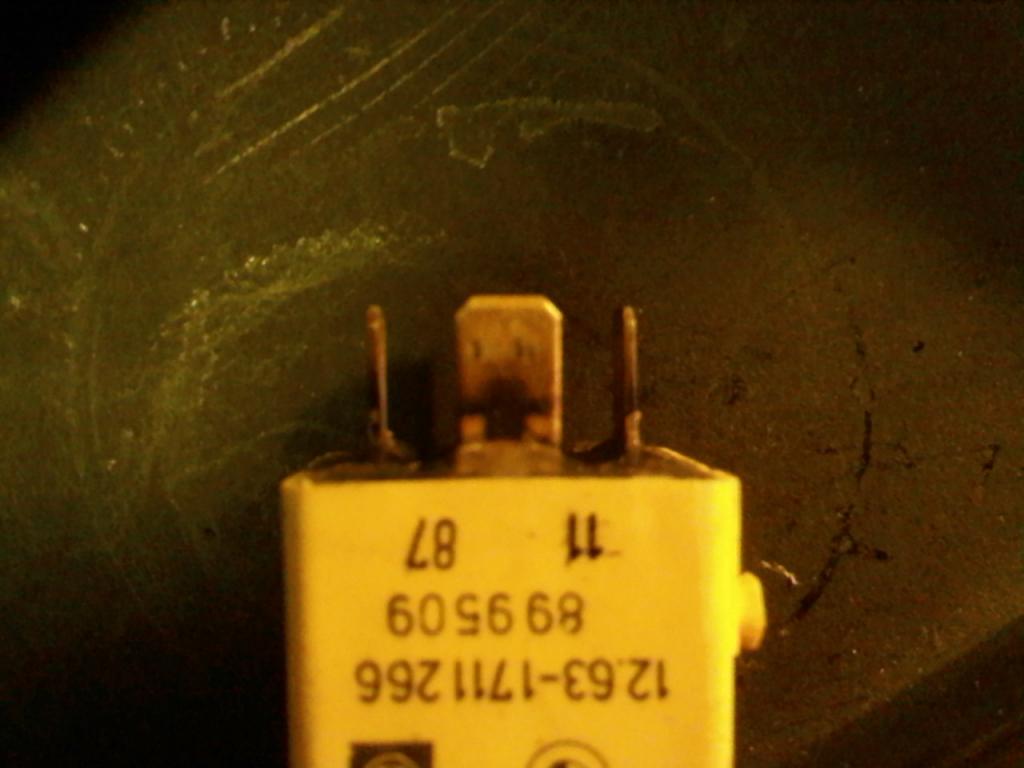

                            Anyone have the part # for the main relay? I'm having trouble finding it on Pelican.
                            I'll see if I can posts a picture of my main relay. I'm not experienced enough with them to know whether it looks bad or just looks like an old relay.
                            • buguhrich
                              • Nov 2008
                              • 141
                              The main relay:
