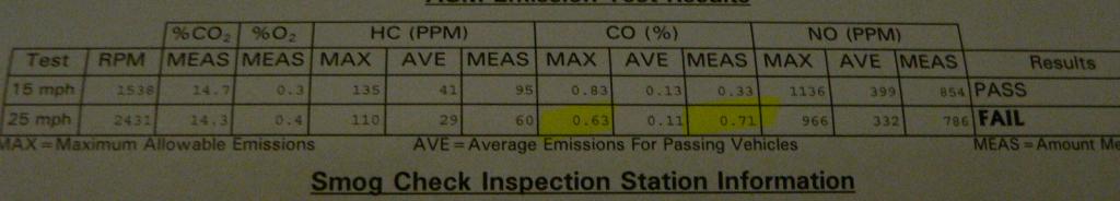

    Okay today I went to take a pre-test to see if my 86 BMW 325es would pass and it ended up failing due to the CO the max you can have is 0.63 and I got 0.71 so does anyone know what I could do to fix this, any suggestions???

      Were HC and NOx also high, even though they passed? If so I'd suspect the catalytic converter.

        Here are the official numbers.
